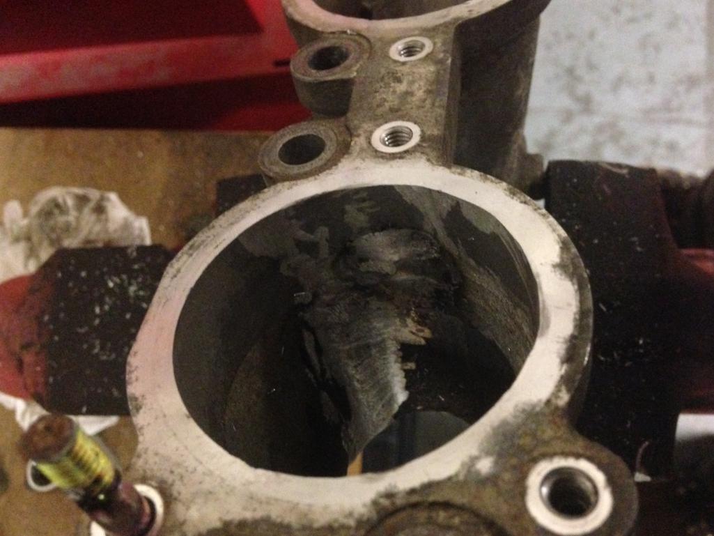

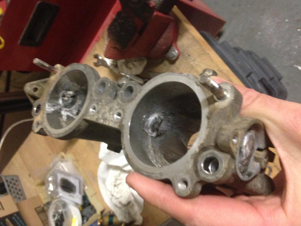

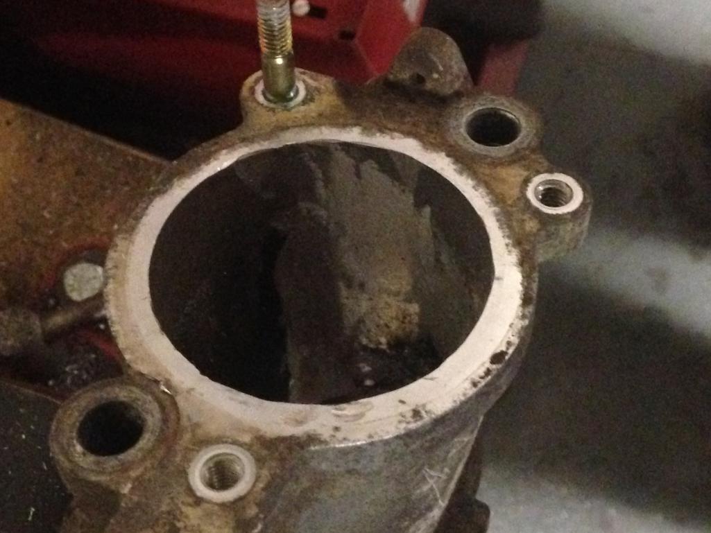

Finished the TGV removal finally! One more part down-perhaps not super necessary but...
Some more pictures just in case anyone needs them for reference in the future.
Welded up throttle shaft holes. Some people on NAISOC, etc. JB weld them up or press rods in there and others even leave the centers connected, but welding seems the most robust solution. It would suck to get a piece of something down into the intake valves. I don't have a hot tank or ultrasonic cleaners so I only was able to grind down the surface oxidation and degrease by hand with a wire brush. The casting is pretty porous and has a lot of embedded oil/fuel so it is a little rough to weld. The easiest way to get a decent weld is to 1) pass the TIG torch over the hole's edge to burn off some of the impurities, 2) clean the tungsten, 3) wire brush/acetone the surface again, and then 4) weld. Having a fume hood is nice too given the amount of smoking.
Cut down as much of the proud welds as possible with a carbide burr (saves flap wheels).
