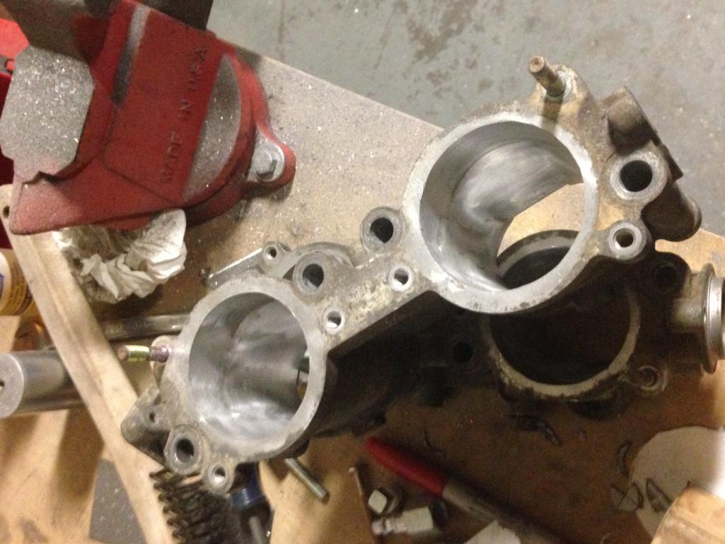

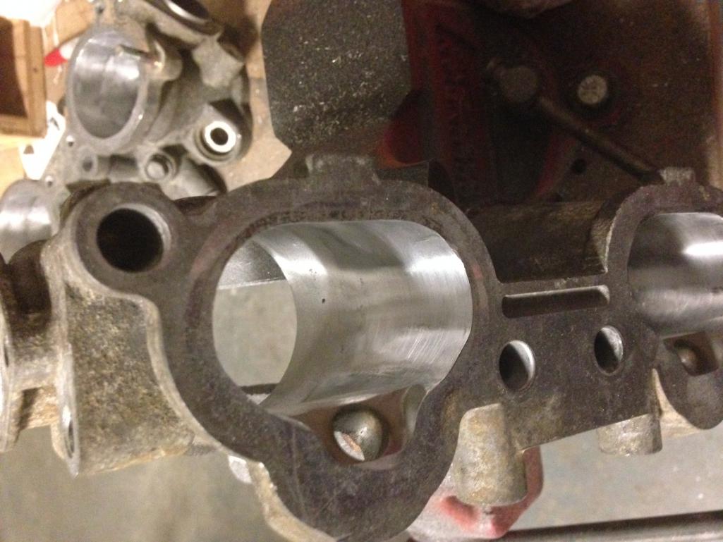

The final product after hitting it with a 60-grit flap wheel. It's a bit tough to judge the surface from the poorly lit pictures, but it's pretty smooth. I'm reasonably happy with how they turned out for a few hours of work. (IMG:style_emoticons/default/smile.gif)
Thinking of blasting these and sending out for powder coating with a batch of stuff later on.
