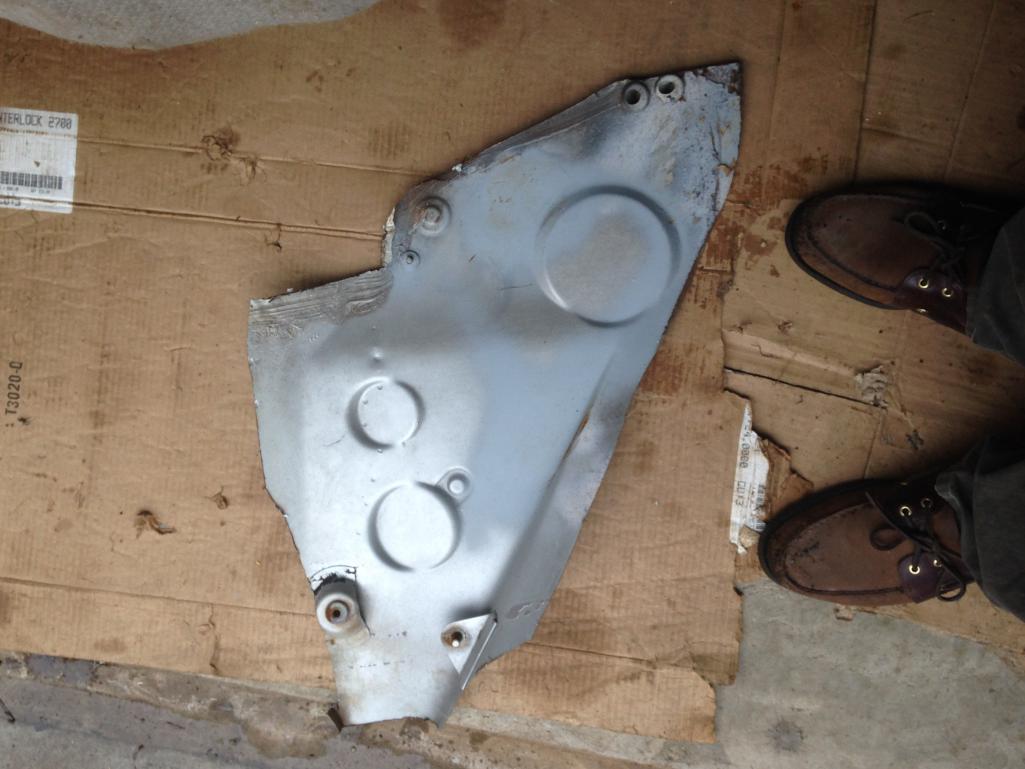

Also unpacked the left rear inner fender wheel Chris (Tygaboy) cut out for me. This should be perfect for filling the huge hole in my left side!
I should have taken a picture of the packing...this sounds dumb but it was the best packed piece of sheet metal I've ever gotten. I wouldn't hesitate to buy from Chris again!

tygaboy   Also unpacked the left rear inner fender wheel Ch...   Jan 9 2017, 06:22 PM
jd74914   It's true, I really do rule... :lol4: Re...   Jan 9 2017, 06:31 PM
