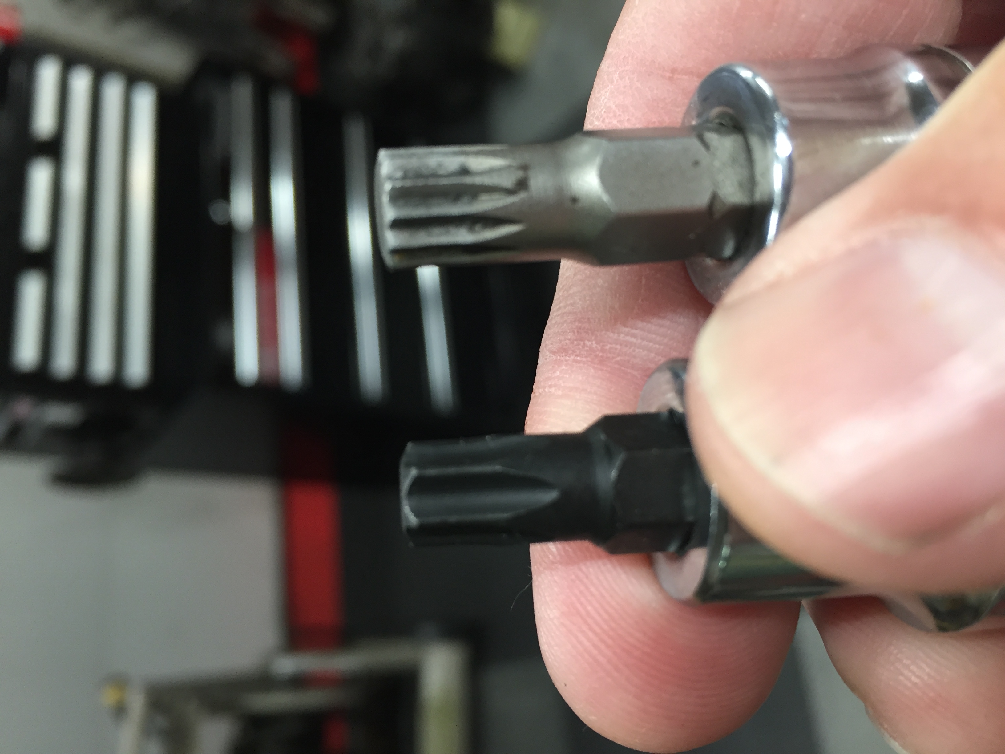

Since this question seems to come up a lot, I f figured I'd post a side by side of star drive (black) vs. triple square (silver) to show the differences.

cuddyk   No... that's Star drive. You'll need an M8...   Jan 7 2017, 01:06 AM

cuddyk   Since this question seems to come up a lot, I f fi...   Jan 7 2017, 12:19 PM
