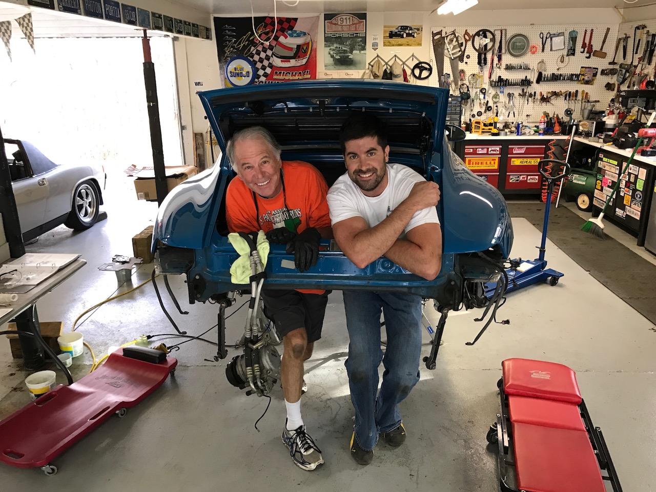

Good luck- it is not that hard. I've done it alone enuf times over the last 45+ years I think I could do it in my sleep...
Helped my son drop the engine/transaxle on our 993- definitely NOT a one man job!!! 914 a piece of cake next to that!!Attached Image
