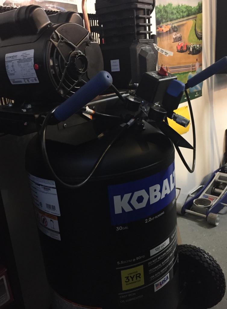

Since PA has been hit with the 20*F temps for a while now and
snow is on the ground. It's been slow progress. My kerosene heater
is having a hard time keeping up. I'm also waiting for my electrician
to be available to run a dedicated line for my new compressor.
So doing some other jobs.

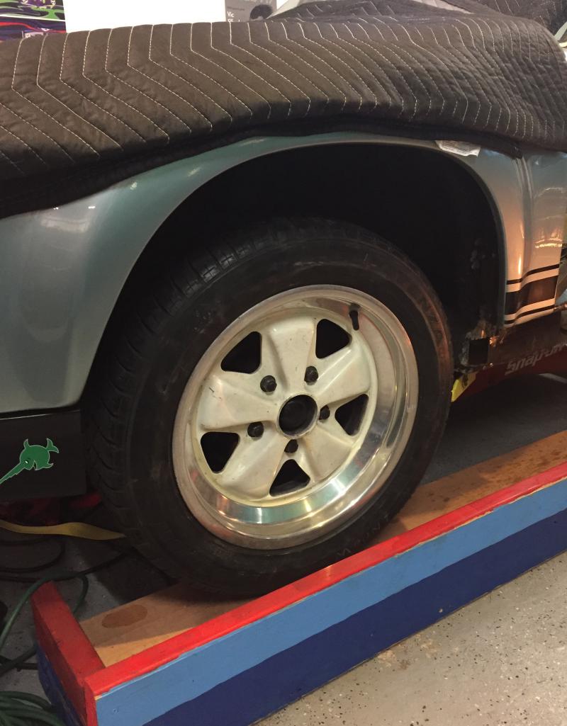

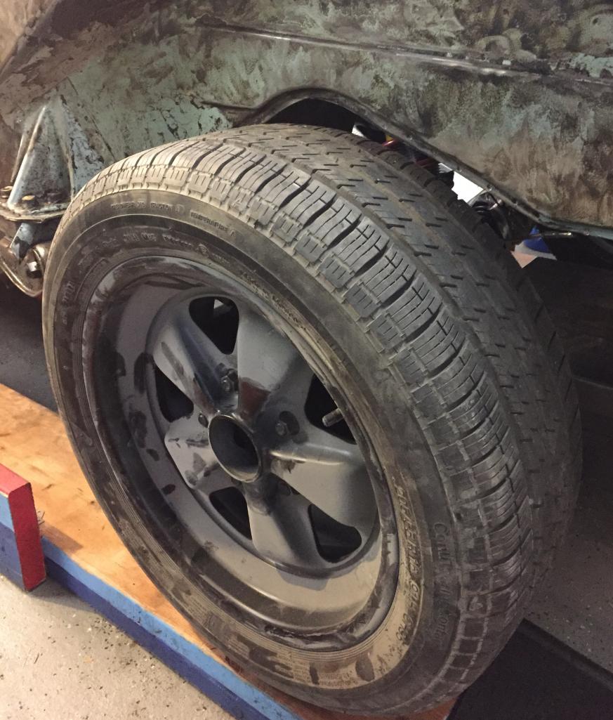

Obtained some "past it" Fuchs to roll the car around for when
the weather breaks and commence with the sandblasting.
