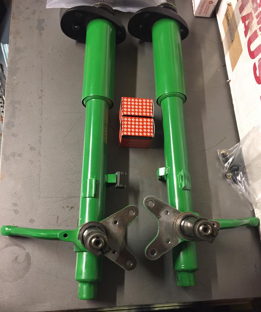

Dion   Since PA has been hit with the 20*F temps for a wh...   Jan 9 2017, 04:06 PM
Dion   Bilsteins   Jan 9 2017, 04:07 PM
914dave   The weather and electrician have conspired against...   Jan 9 2017, 05:45 PM
tygaboy   Your Bilsteins are making me green with envy... :...   Jan 9 2017, 06:17 PM
