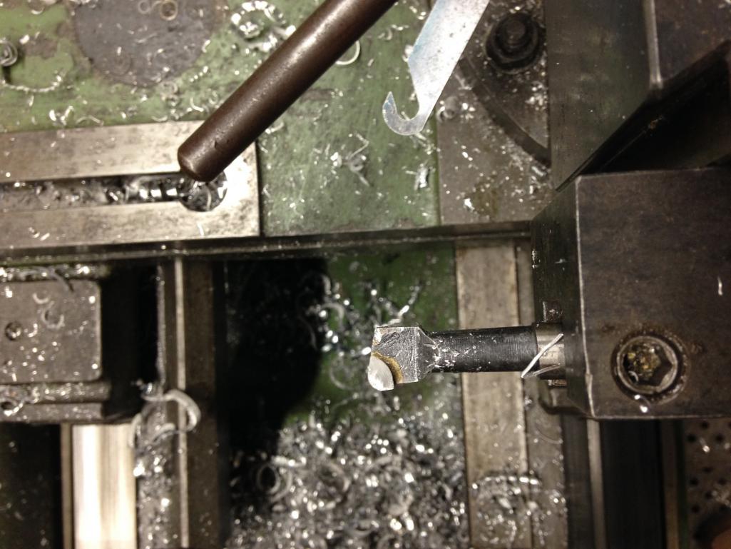

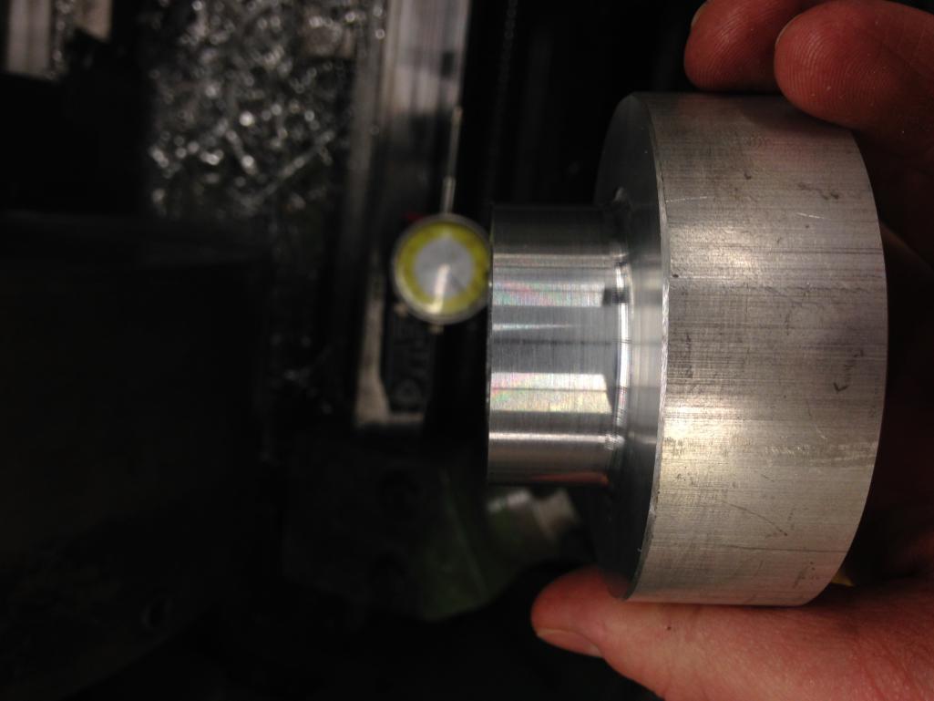

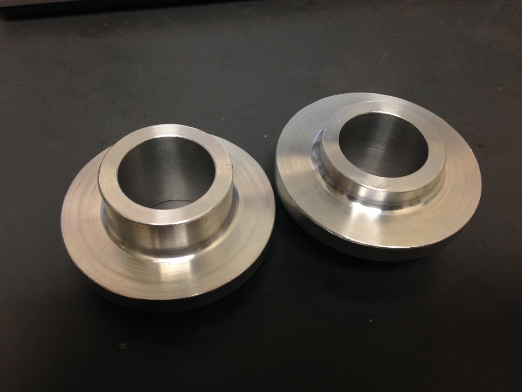

At lunch I had a bit of time to turn the sway bar bearing mounts down. I'm pretty happy how they turned out-press fit is good to 0.0005" per telescoping gauge/mic (right in the middle of manufacturer requirements) and machined surface finish is pretty good. Didn't have any radius cutters, so a trashed old one got ground down. It actually worked pretty well besides a little chatter-a little thicker neck would have been nice. (IMG:style_emoticons/default/biggrin.gif)
Getting better with this whole turning thing. Ran out of time to drill the mounting holes and cut the backer plate. Another day...

jd74914   Finished up the sway bar bearing mounts over lunch...   Jan 11 2017, 03:01 PM
tygaboy   LOVE those sway bar bearing mounts! Just beaut...   Jan 11 2017, 03:31 PM
jd74914   LOVE those sway bar bearing mounts! Just beau...   Jan 11 2017, 05:09 PM
