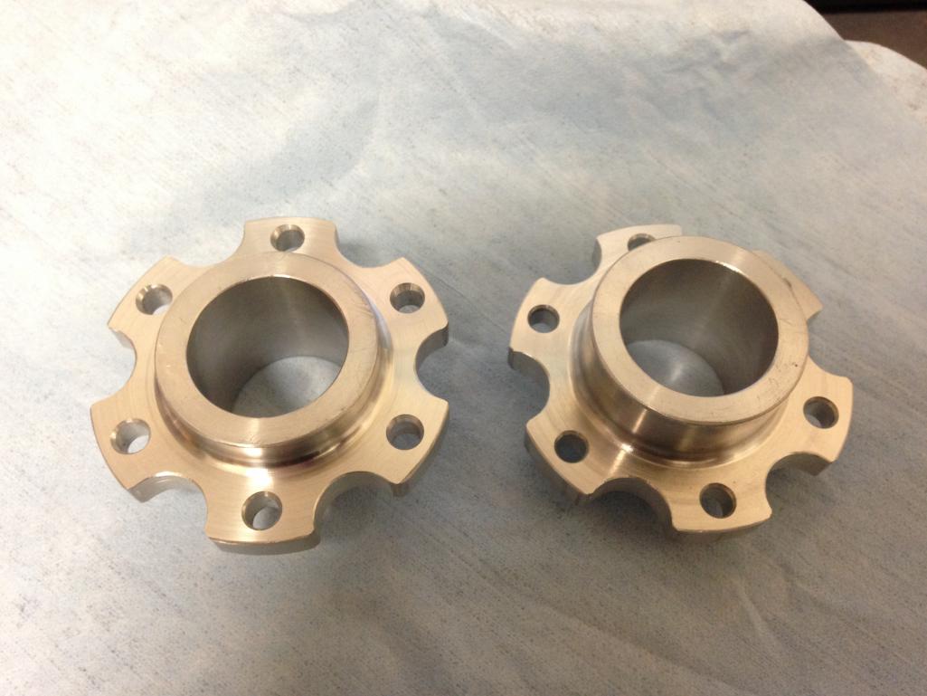

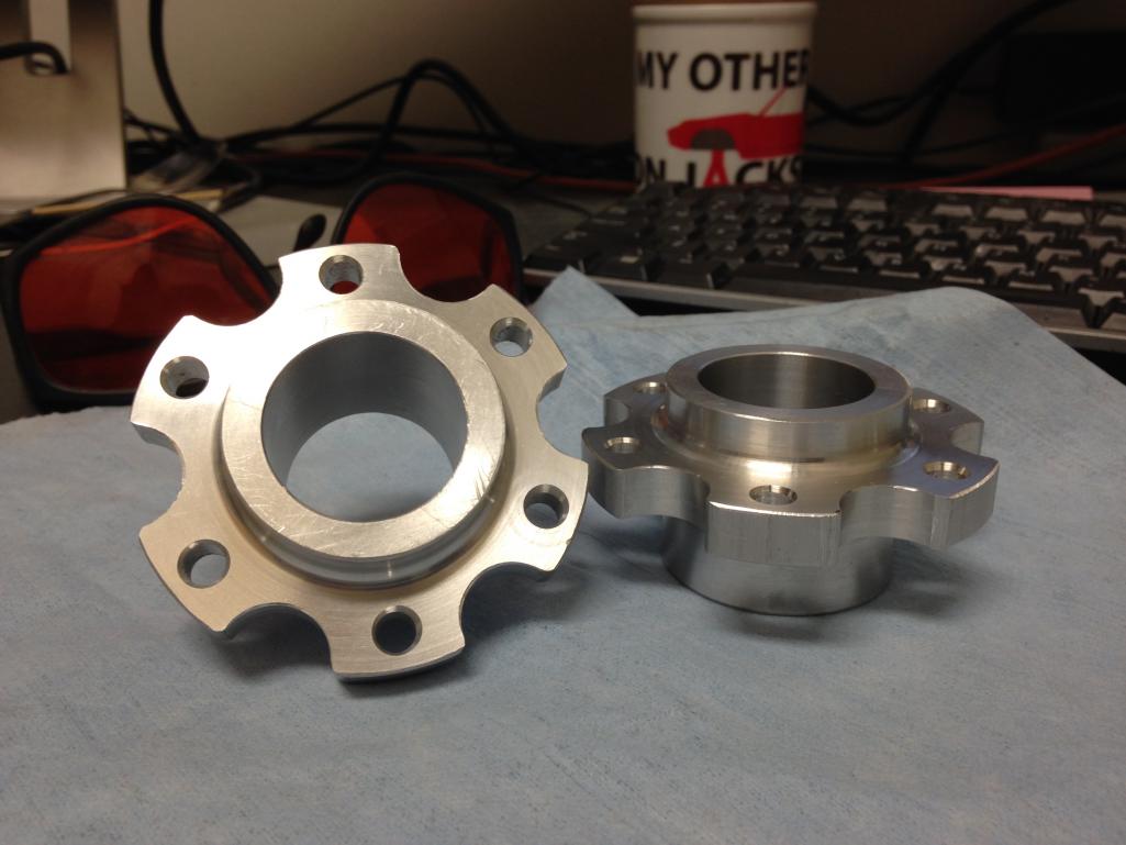

Finished up the sway bar bearing mounts over lunch today. Decided to go to a smaller outer diameter 6-bolt flange using M6 bolts vs. the OEM triple M8 bolt setup. The reliefs cut into the sides are really just there to look cool-they save ~20g (each part weights ~130g) which doesn't really do anything for a 900kg car. (IMG:style_emoticons/default/laugh.gif)
Now just need to make some quick nuts plates and redrill/bore the through hold bigger on the inner fender stiffener and all of the vehicle attachment stuff will be done.
