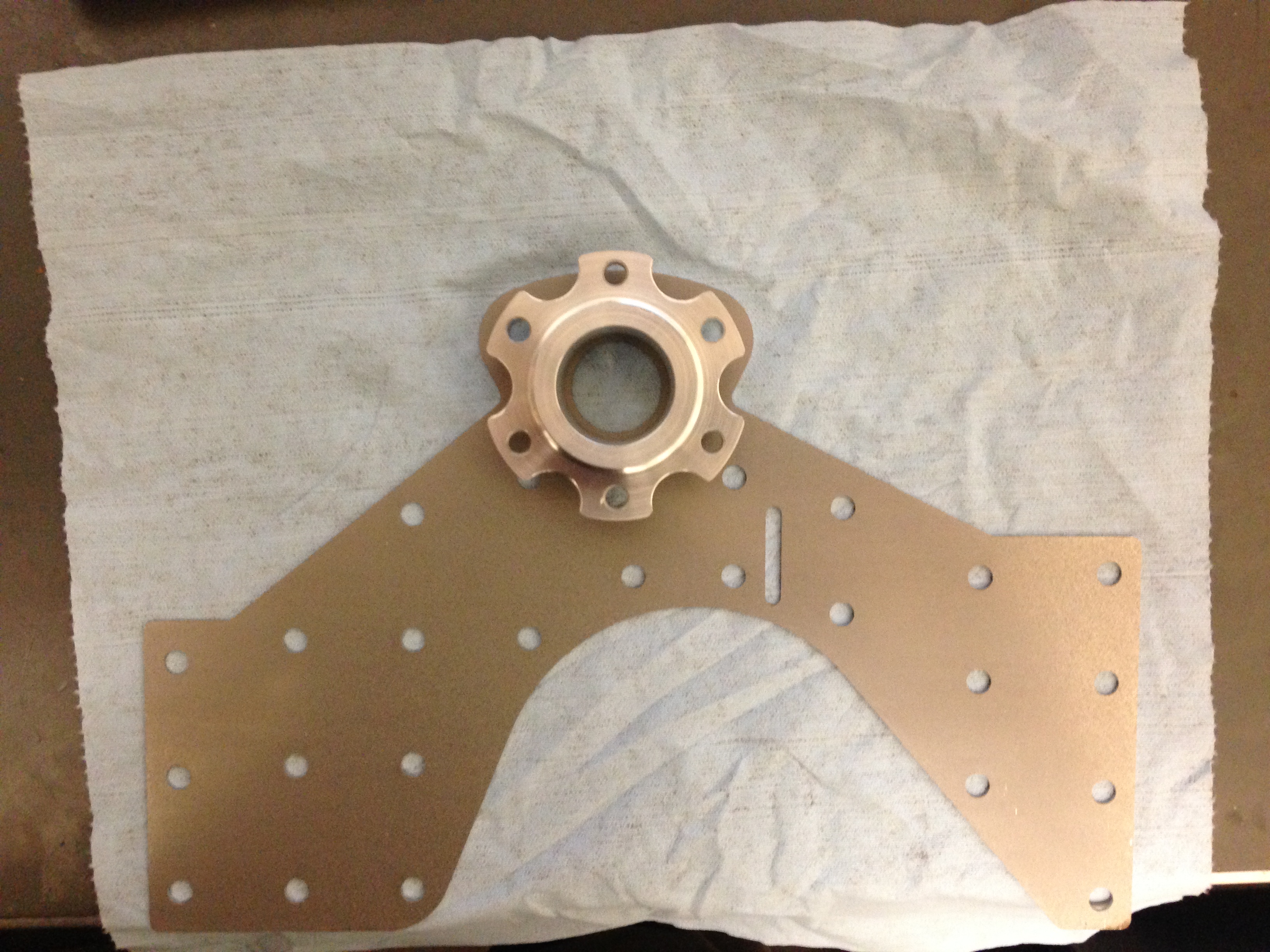

LOVE those sway bar bearing mounts! Just beautiful. Nice work. (IMG:style_emoticons/default/wub.gif)

QUOTE(tygaboy @ Jan 11 2017, 04:31 PM) *
Thanks!! (IMG:style_emoticons/default/smile.gif)
Forgot to add this picture before...its tough to see with the iPhone image warping, but with the reliefs it fits just perfectly into the recess and avoids the stiffener edge welds (save ~3/4" portion on top). Totally accidental but the smaller attachment bolts let it retain the stock hole spacing too which is awesome.
