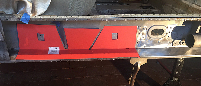

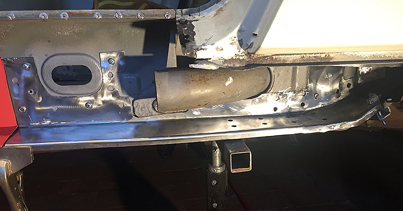

OK making patches. Can you guys le me know if this looks like a decent plan?
I haven't welded anything in yet. I have created this piece that replaces the bottom rear of the drivers long. I will put a second layer over this that extends over the butt weld ar the rear. Maybe another 3 inches.
About halfway toward the front, the bottom of the long is OK. It just has holes along the bottom inner edge. So I am planning not to remove the bottom of the long—I will just double up on the existing. I will bend it and let it go up pretty high—I haven't determined how high yet—to reinforce the E-Brake area.

mbseto   You're planning a reinforcement kit on the out...   Jan 16 2017, 09:08 AM
amfab   You're planning a reinforcement kit on the ou...   Jan 16 2017, 10:05 AM
Andyrew   Looks good. If your doing it on the inside then ma...   Jan 16 2017, 12:31 PM
amfab   OK, so based on Andyrew's comments I went out ...   Jan 21 2017, 08:15 PM
