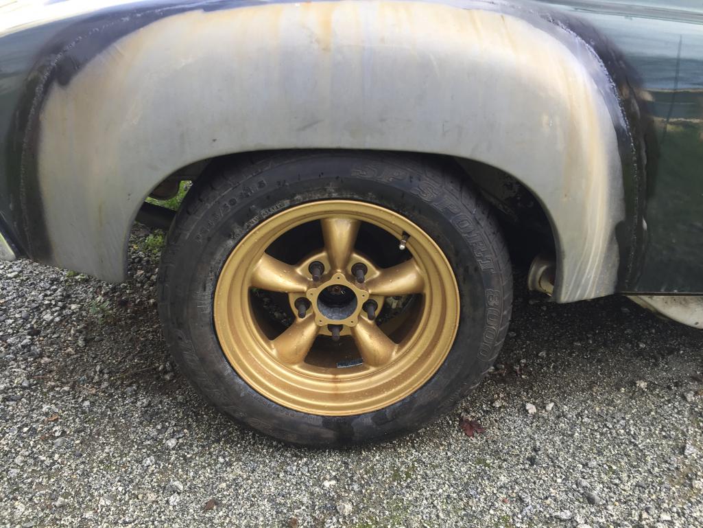

Added 245-50 15's in the rear on 9x15 ARE's.

sixnotfour   how old those Dunlops ??,,,, I had a nos pair I p...   Feb 2 2020, 03:53 PM
B2524   The rears are American Racing. They will build th...   Feb 2 2020, 05:00 PM
