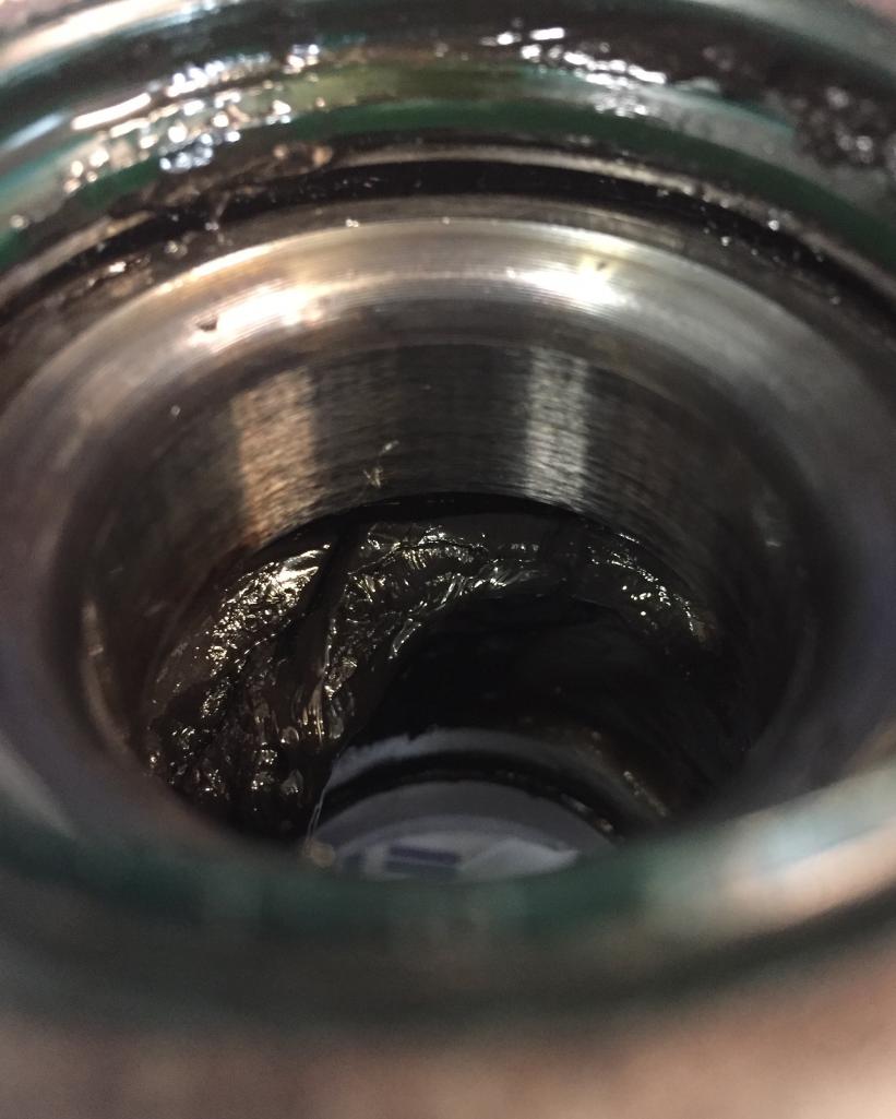

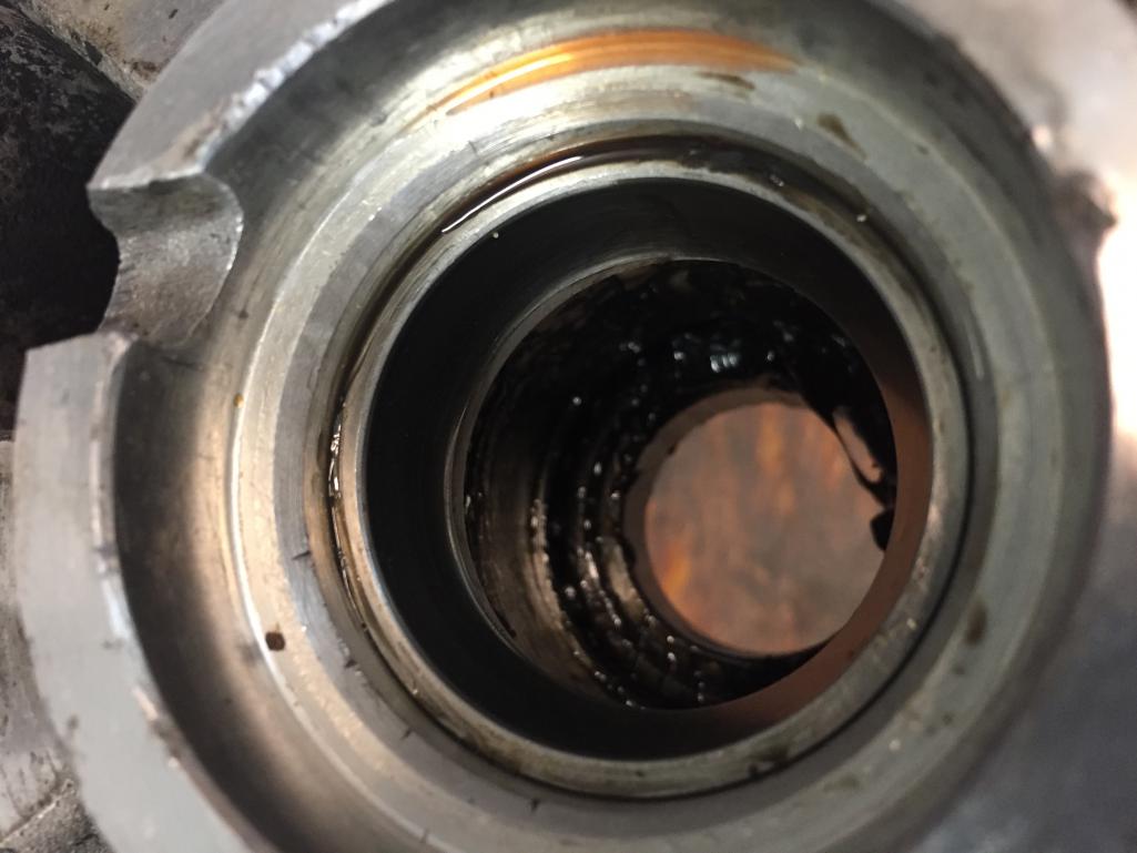

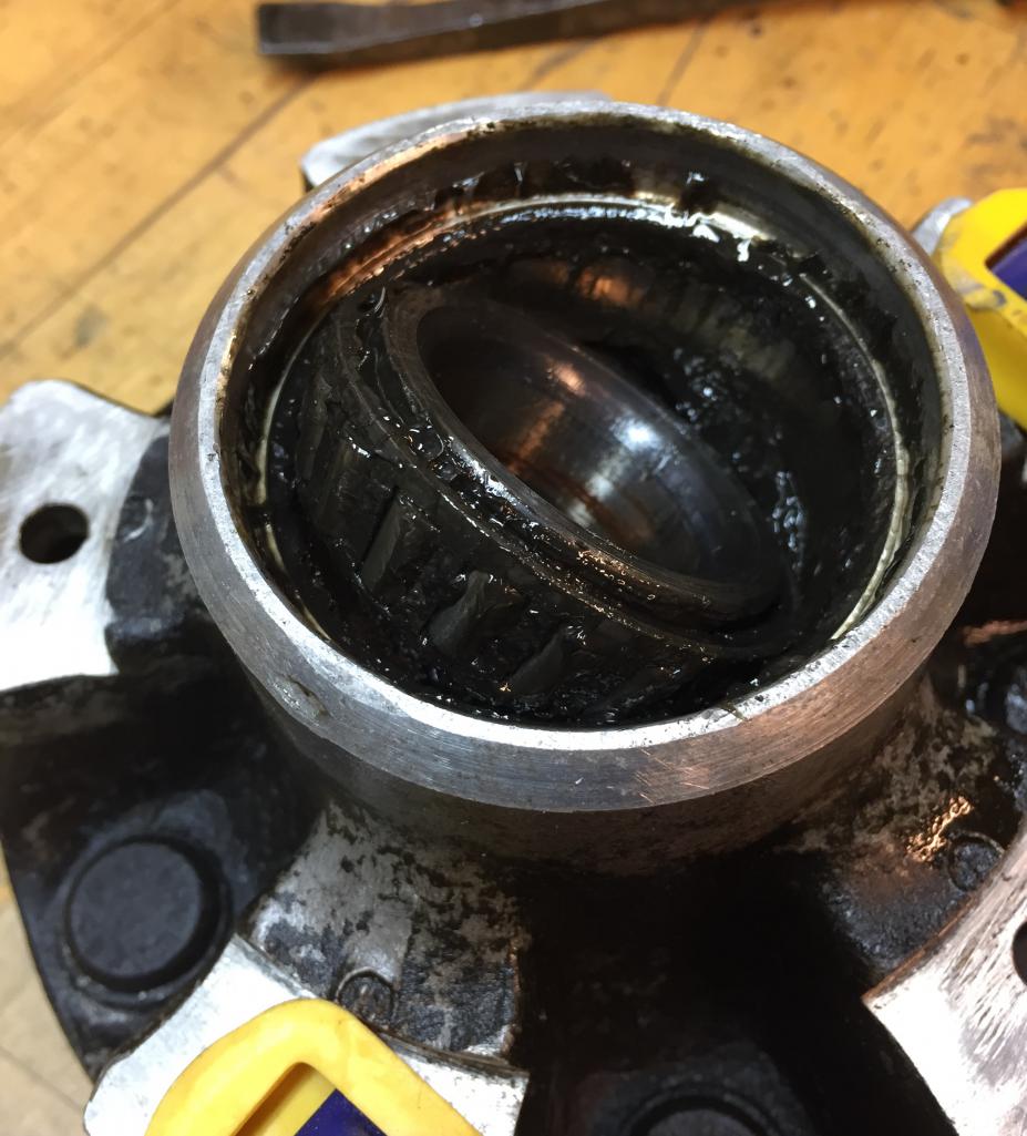

Dion   Baked the hubs at 250*F for 25 minutes to coax th...   Jan 22 2017, 09:28 PM
Dion   Clean hubs   Jan 22 2017, 09:29 PM
Dion   Repacked   Jan 22 2017, 09:30 PM
