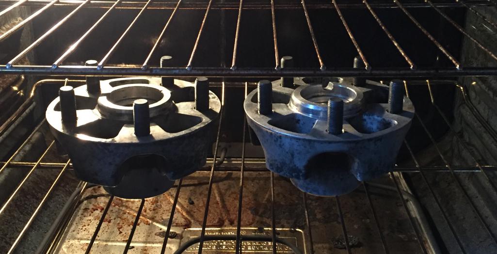

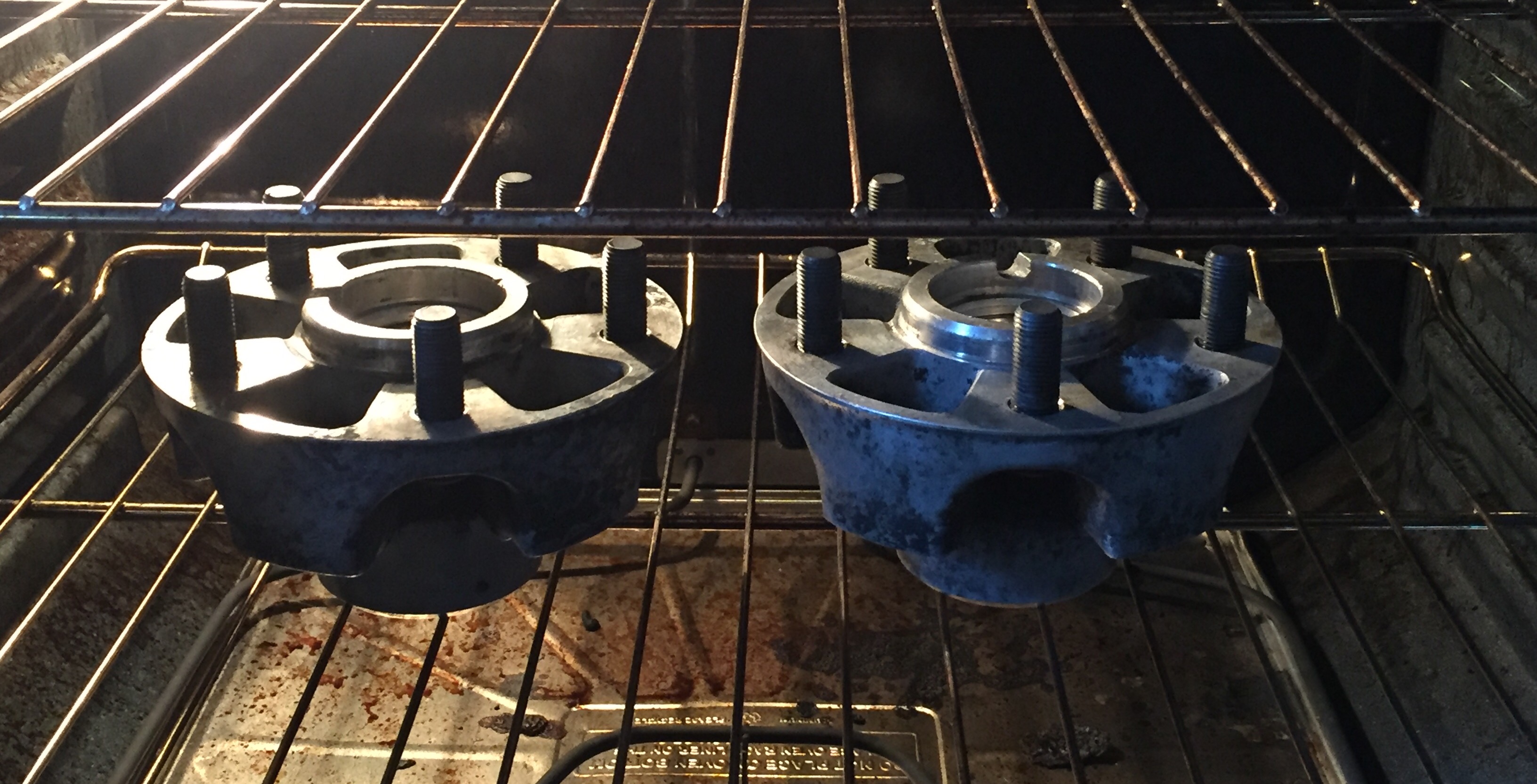

Baked the hubs at 250*F for 25 minutes to coax the
races out.

Dion   Tackling front suspension work. Replaced hub beari...   Jan 22 2017, 09:26 PM
Dion   Baked the hubs at 250*F for 25 minutes to coax th...   Jan 22 2017, 09:28 PM
