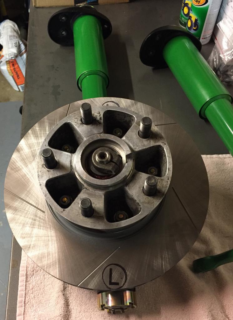

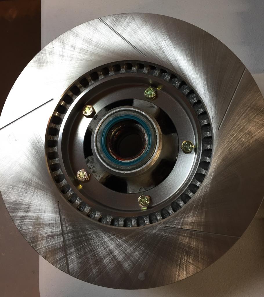

Dion   Tackling front suspension work. Replaced hub beari...   Jan 22 2017, 09:26 PM
Dion   Baked the hubs at 250*F for 25 minutes to coax th...   Jan 22 2017, 09:28 PM
Dion   Clean hubs   Jan 22 2017, 09:29 PM
Dion   Repacked   Jan 22 2017, 09:30 PM
Dion   New ball joints installed. Pay attention to the ty...   Jan 22 2017, 09:35 PM
Dion   Rotors   Jan 22 2017, 09:36 PM
