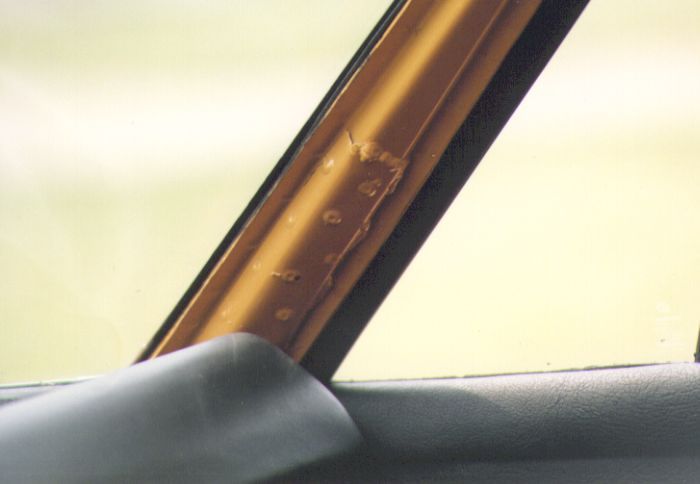

Ya know, I remember reading something in Pano many years ago about the Daytona winning Sunoco 914/6 GT being sold at the end of the 1971 season because the chassis was "shot". And I kind of remember something about Jacques Duvall switching back to a 911 for 1972 because it had a stronger chassis. I found one article about that car but there was no reference to chassis flex in it. the windshield cracked, if I remember correct Yep, here was the Factory Fix! This is in the #2 Nurburgring car ![]() |
