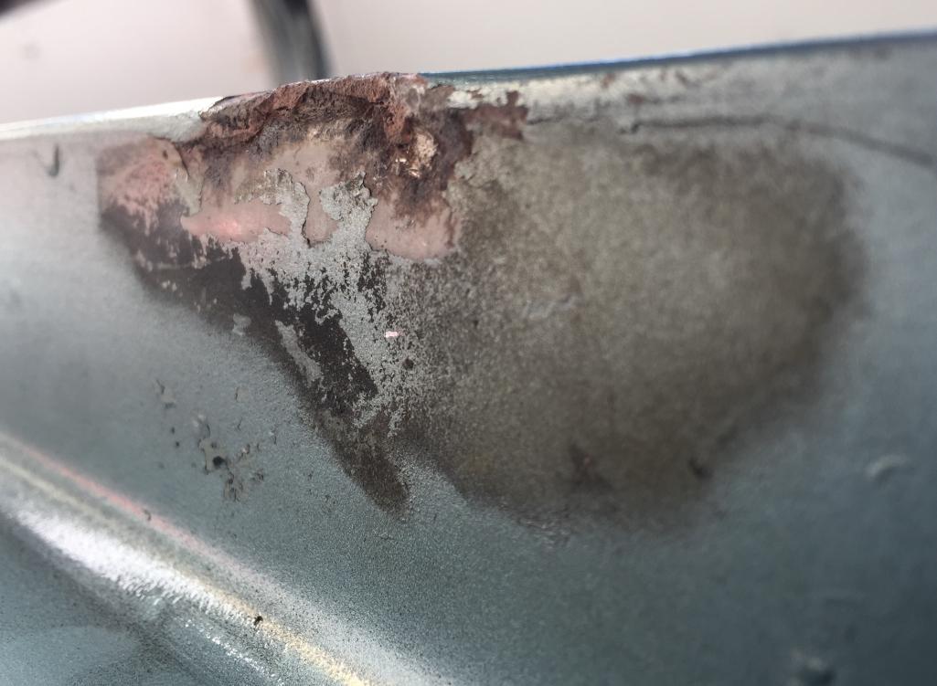

Dion   Some garage time this afternoon. Started prepping ...   Jan 26 2017, 04:23 PM
Dion   Also some body filler escaped proper contouring fr...   Jan 26 2017, 04:27 PM
