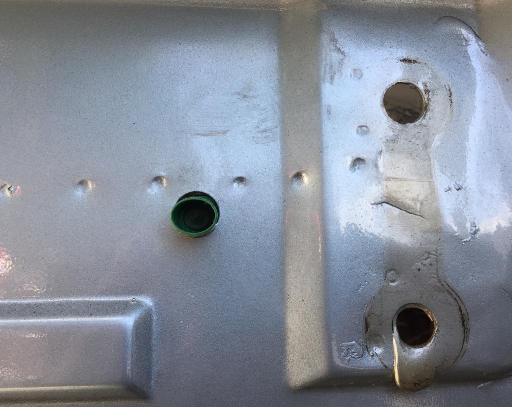

Curious? Anyone have a "proper" hole on right side of rear of car near bumper mounts?
Looks like it's a mirror placement for tow eye bolt on left minus the tube and bracing.

Dion   Curious? Anyone have a "proper" hole on ...   Jan 26 2017, 04:31 PM
altitude411   Curious? Anyone have a "proper" hole on...   Jan 26 2017, 04:49 PM
Dion   Tow hook spot?   Jan 26 2017, 04:32 PM
914dave   Mine has the same hole. No idea what it's for.   Jan 26 2017, 04:49 PM
tom.esh   My replacement pan has that hole. I don't thin...   Jan 26 2017, 06:29 PM
