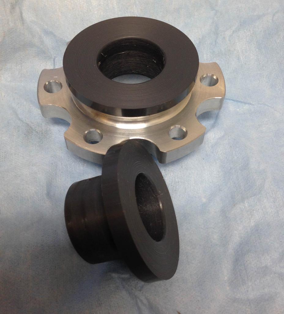

Today over lunch I turned some ABS "bushings" down for trial fitting the front sway bar. I was to test the install before having the mounts anodised, so I figured it'd be better to make a faux bushing to avoid ruining a good one on the uninstall.

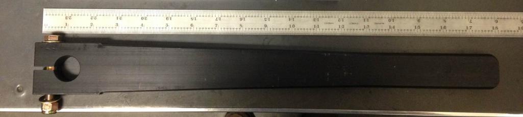

The aluminum plate came in to make the "fixture" for machining the front sway bar arms. Almost done with the arm and fixture design-hopefully some CAD drawings later this week. Need to cut down this beast! ~18 inches is just a little too long! (IMG:style_emoticons/default/laugh.gif)

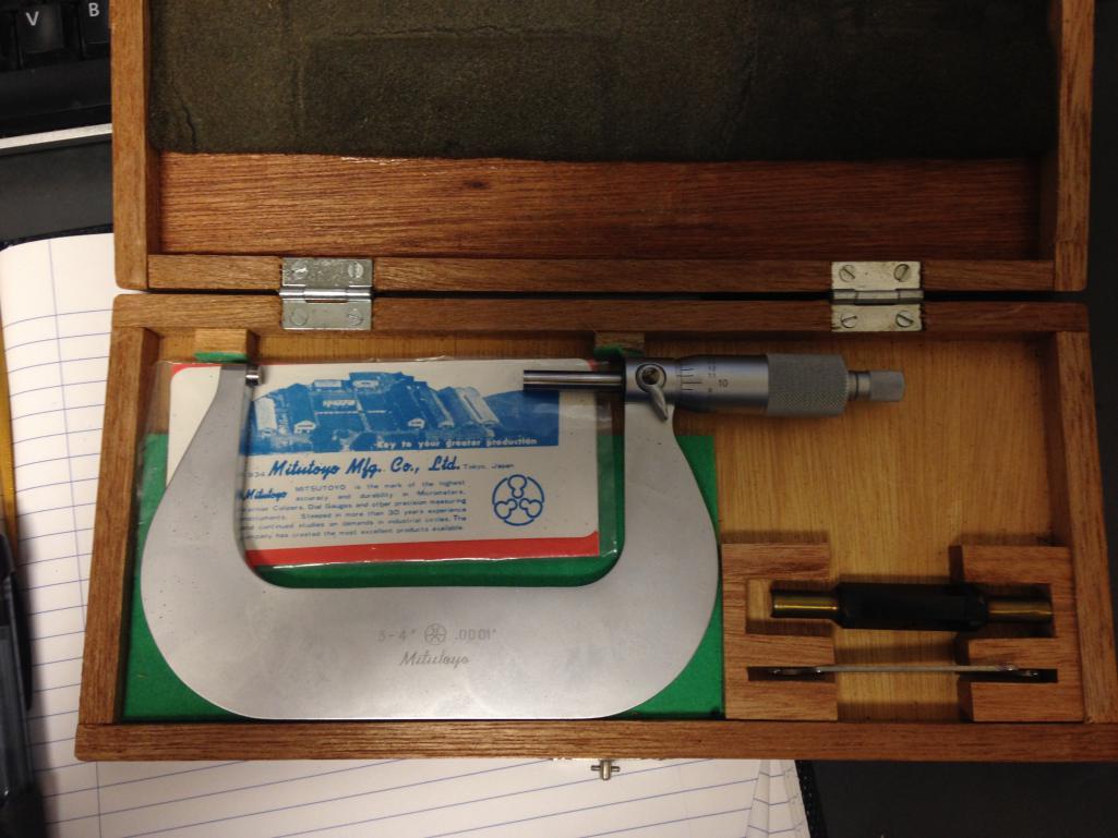

Semi-unrelated, but I've been gathering measurement equipment for blueprinting the engine when it gets rebuilt and I just got an awesome eBay deal on a sweet vernier mic...and just had to show off! This morning I adjusted it to within 0.0001" on a gage block. (IMG:style_emoticons/default/biggrin.gif)
