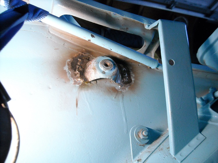

In the last installment I had painted up the hinge hardware. then after mounting them with the new rollers I noticed a crack on the passenger side trunk lid mount. I had already repaired the drivers side before painting it and had looked at the pass side then and it looked ok. ..... Well it wasn't. Fortunately I found it while I could still get in there, unfortunately it was previously repaired by brazing it (IMG:style_emoticons/default/mad.gif)
So I had to grind out all the brass and get in there with the mig to fix it right. I am still learning with this mig but did manage to get in there, it should hold up now. Then I had to fix the paint I just burned up with the mig.... (IMG:style_emoticons/default/dry.gif)

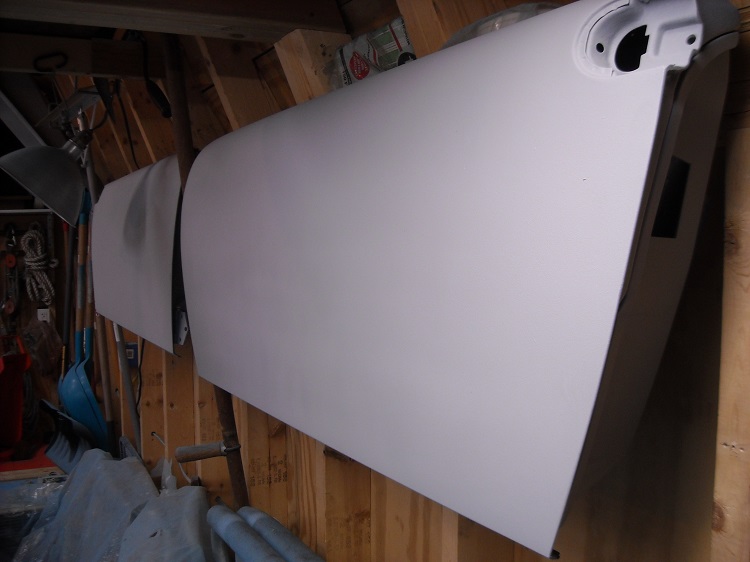

Since I had just picked up the doors from a local restoration shop that I had taken them to be blasted inside and out. I started on these.
then found that the shop had added some warp to my doors when blasting them. (IMG:style_emoticons/default/headbang.gif)
so they were going to need some more bodywork. They are ready now just waiting on some warmer temps to paint them (might be a couple months now)

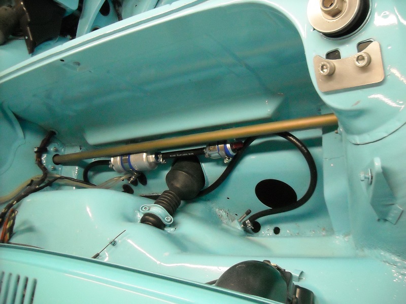

Worked on mounting the fuel pump and filter. not a lot of room with the sway bar there.

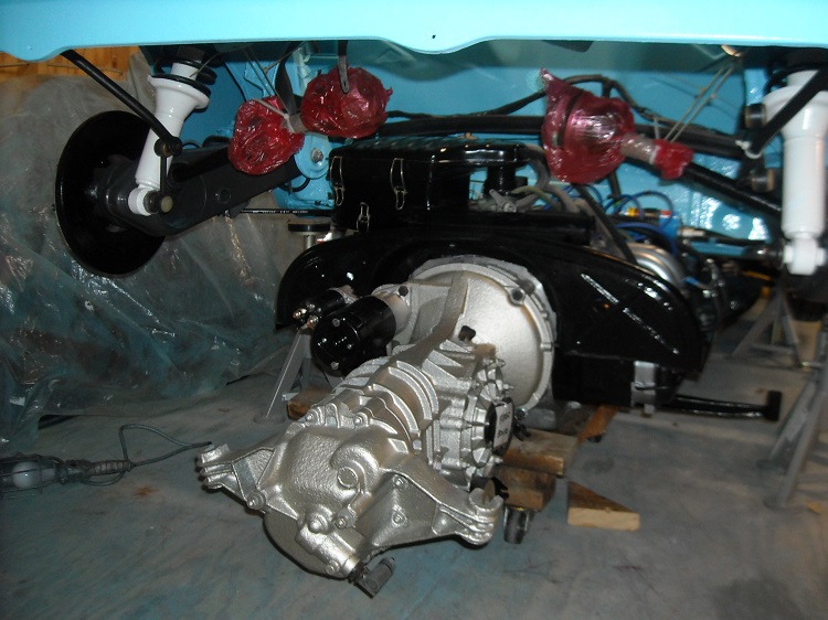

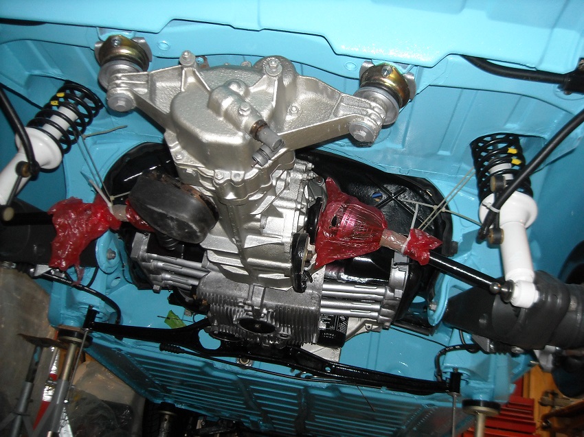

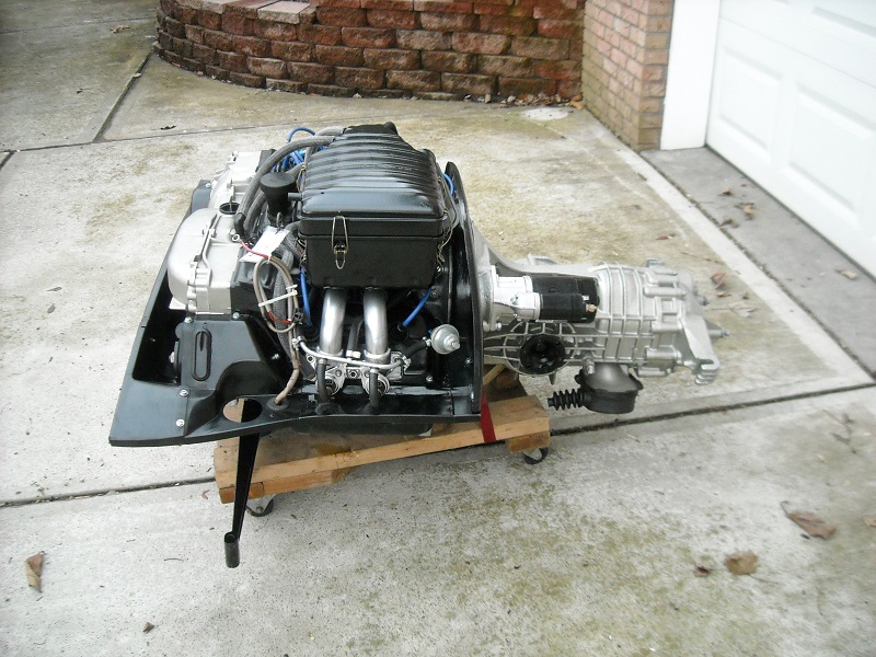

After joining the engine and trans and strapping it to a cart, it started on its journey from the garage to the shed.
I had to use the winch to pull the combo up the ramp into the shed, and into place under the car.
Using a couple pieces of allthread on the front motor mounts and a floor jack under the trans, I was able to get the engine raised into place without damaging anything. (IMG:style_emoticons/default/biggrin.gif)
although this is a slow method it gave me a lot of opportunity to make sure everything was clearing. I angled up one side first to clear the fuel injector lines and clear the tins on the suspension bolts.
You can see the allthread still in place this picture above. It worked great..
