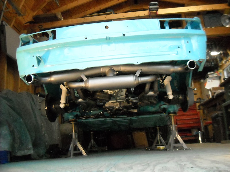

After much parts cleaner, elbow grease and a liberal dose of Barkeepers Friend my once cruddy looking Heat Exchangers shined up nicely.

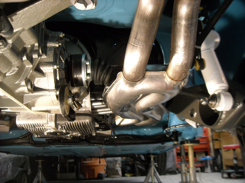

To keep the copper exhaust gaskets in place while I installed the HE's I sprayed them with some of this. it provided just enough stickiness to keep them in while I fitted the HE's

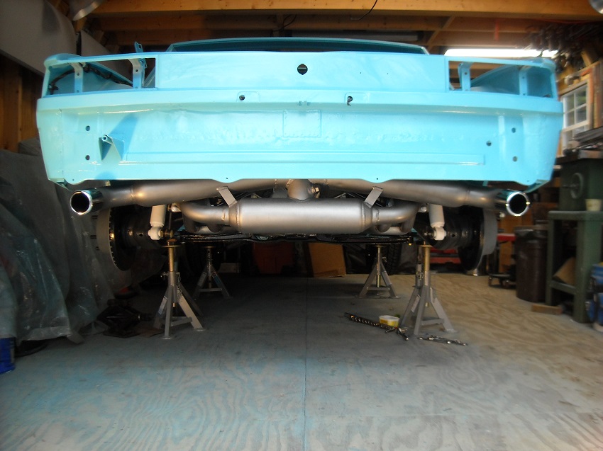

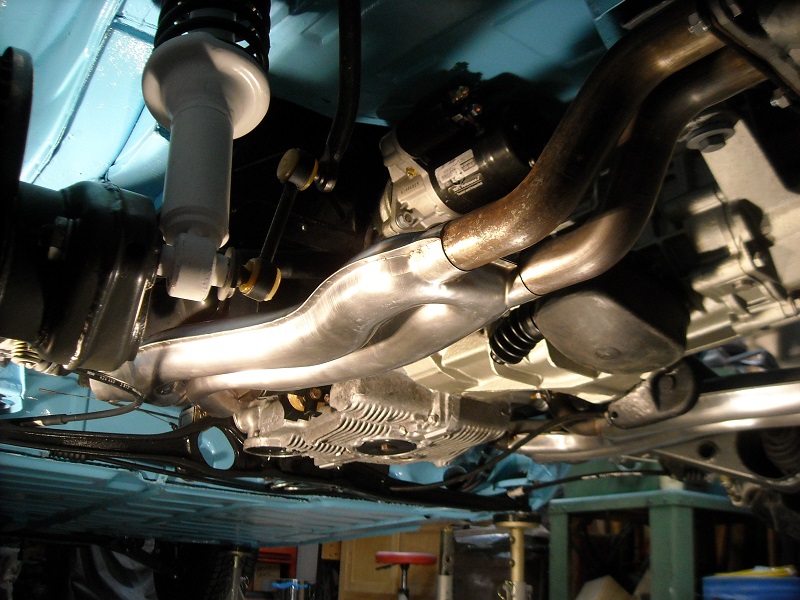

Then I could put on the Custom Deluxe Triad Exhaust System.

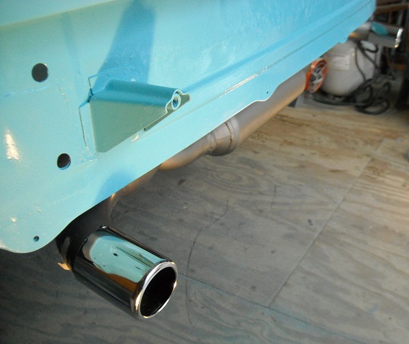

I had a bung added for an AFR gauge.
And some Chrome tips for a little extra Bling.
These pipes fit up PERFECTLY. Thanks Dave.
very high quality, can't wait to hear how they sound.
