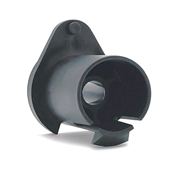

I have an 8 or 10 lb. spool on the welder, so it’s not exactly the 2lb spool problem, but I was wondering about the wire sticking as it unspools. I noticed that the reel is a little loose on the spindle adaptor—it can slop side to side on the adaptor a little. There is a tab to the side of the adaptor that fits into the hole on the reel (see picture). Because it is loose, it seems that the tab could pop out. I do not know if the spindle is driven with the motor, but maybe this has something to do with it. This is odd because its a Lincoln welder with a Lincoln adaptor and Lincoln spool on it.
Also, the welder was sitting in my garage for 10 years with this spool on it. Some of the wire on the outside layers was corroded, so I spooled off about 5 lbs. to get to really clean wire. What is the shelf life of this stuff? I do not see any corrosion on the wire.
The welder did not have that much time on it before I stopped using it—the stuff I have been doing over the last decade was all TIG. The MIG was not used enough to wear the liner, but can the liners get corroded?
Maybe I’ll just buy a liner, a fresh roll of .030 and a roll of .025 just to elminate everything. Any wire brand recommendations?
