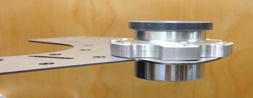

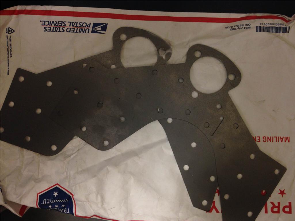

Framed out the necessary larger holes in the sway bar stiffeners this afternoon. They look just a little ridiculous. (IMG:style_emoticons/default/laugh.gif) Now they're ready for welding onto the car.
It was interesting, I noticed while indicating the original bar hole on the mill that the holes don't seem to be quite round. There must be some bearing slop or something in one of the axes of the laser that cut these since they're oval by a bit over 5 mils IIRC. Doesn't make any difference at all in performance and the pieces are really nice, just thought it was funny.
