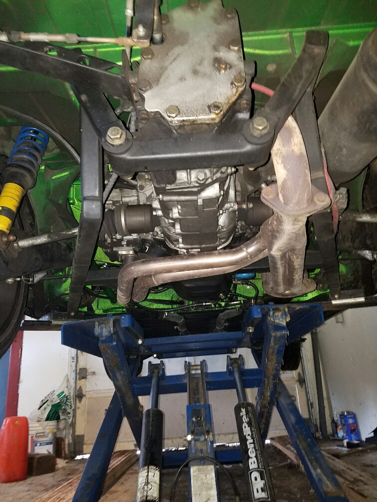

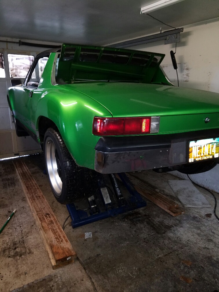

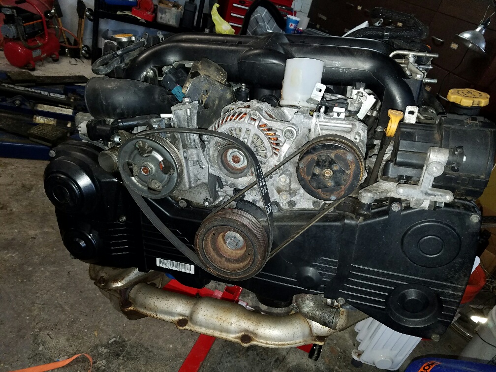

Okay well I've got a few picture. First 2 are of my 09 2.5 turbo motor on the stand. Then my car on the rack & an underside picture from the back. I've got to go do a few things now so plan to pull the motor in a few hours
