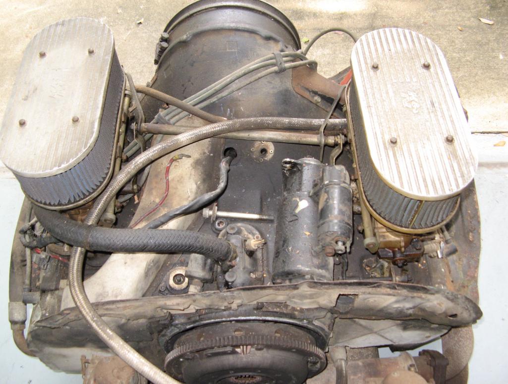

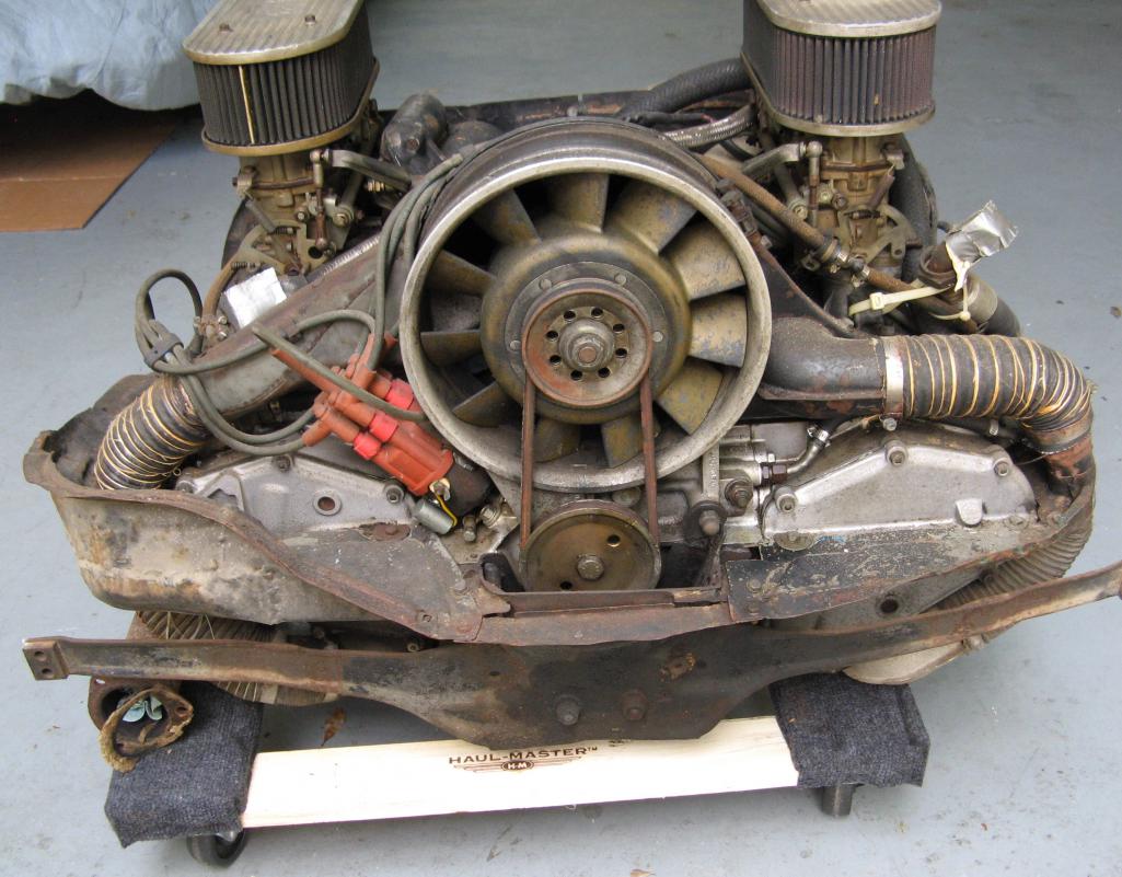

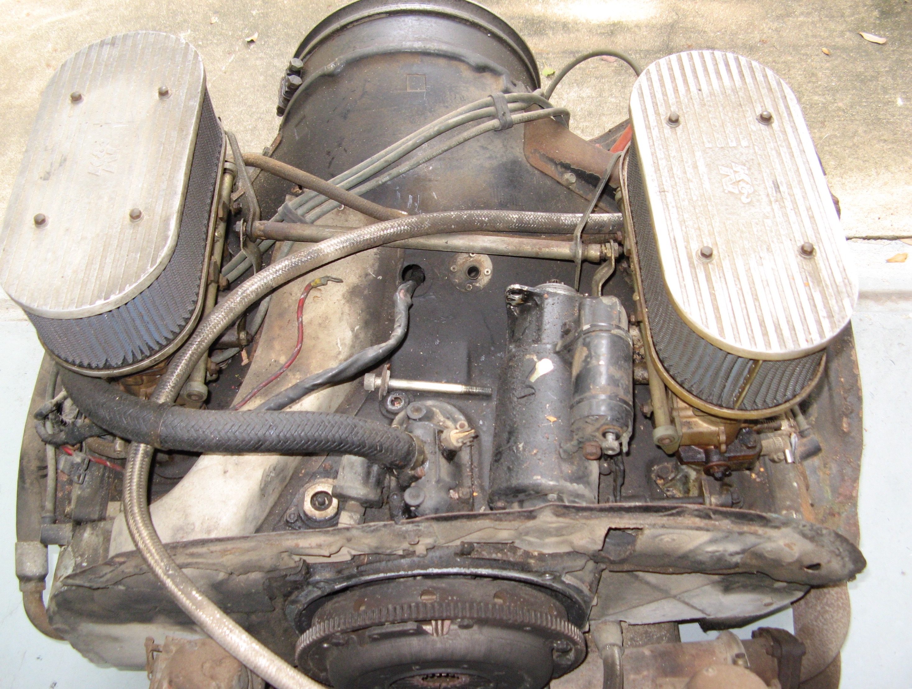

I'm updating with older pics here since it is my build thread. So it
serves as a great history.
So first is the 2.4 when I first purchased it nearly 2
years ago. I then cleaned it up and began replacing items
