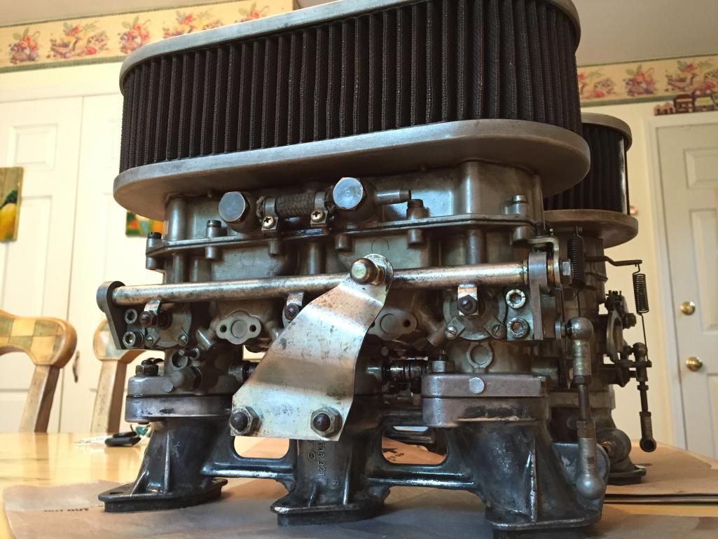

Took the carbs off for cleaning and replaced all the seals.

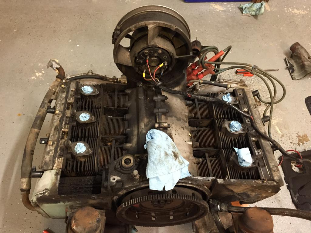

Dion   Some garage time this afternoon. Started prepping ...   Jan 26 2017, 04:23 PM
Dion   Also some body filler escaped proper contouring fr...   Jan 26 2017, 04:27 PM
Dion   Hammered.   Jan 26 2017, 04:27 PM

Dion   Took the carbs off for cleaning and replaced all t...   Feb 5 2017, 10:28 AM

Dion   So the upper valve covers that I did in silver pai...   Feb 5 2017, 11:00 AM
Dion   Put the carbs back on. Added the surrounding sheet...   Feb 5 2017, 11:04 AM
Dion   Engine tin   Feb 5 2017, 11:06 AM
