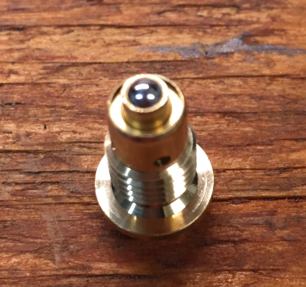

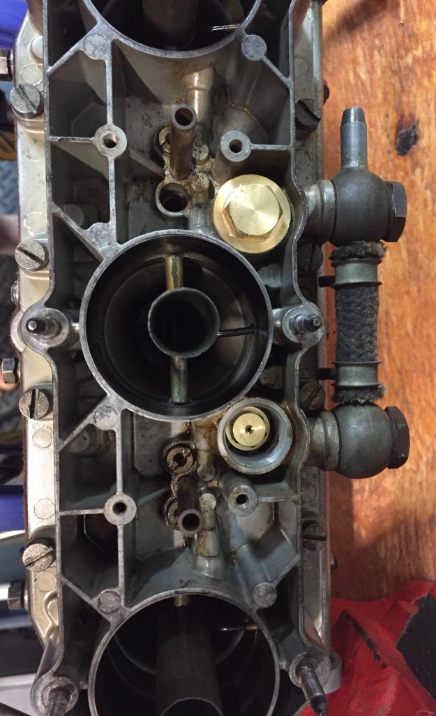

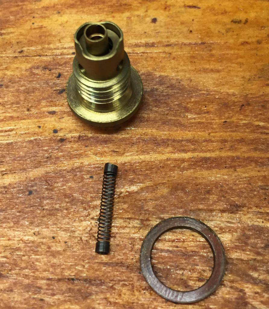

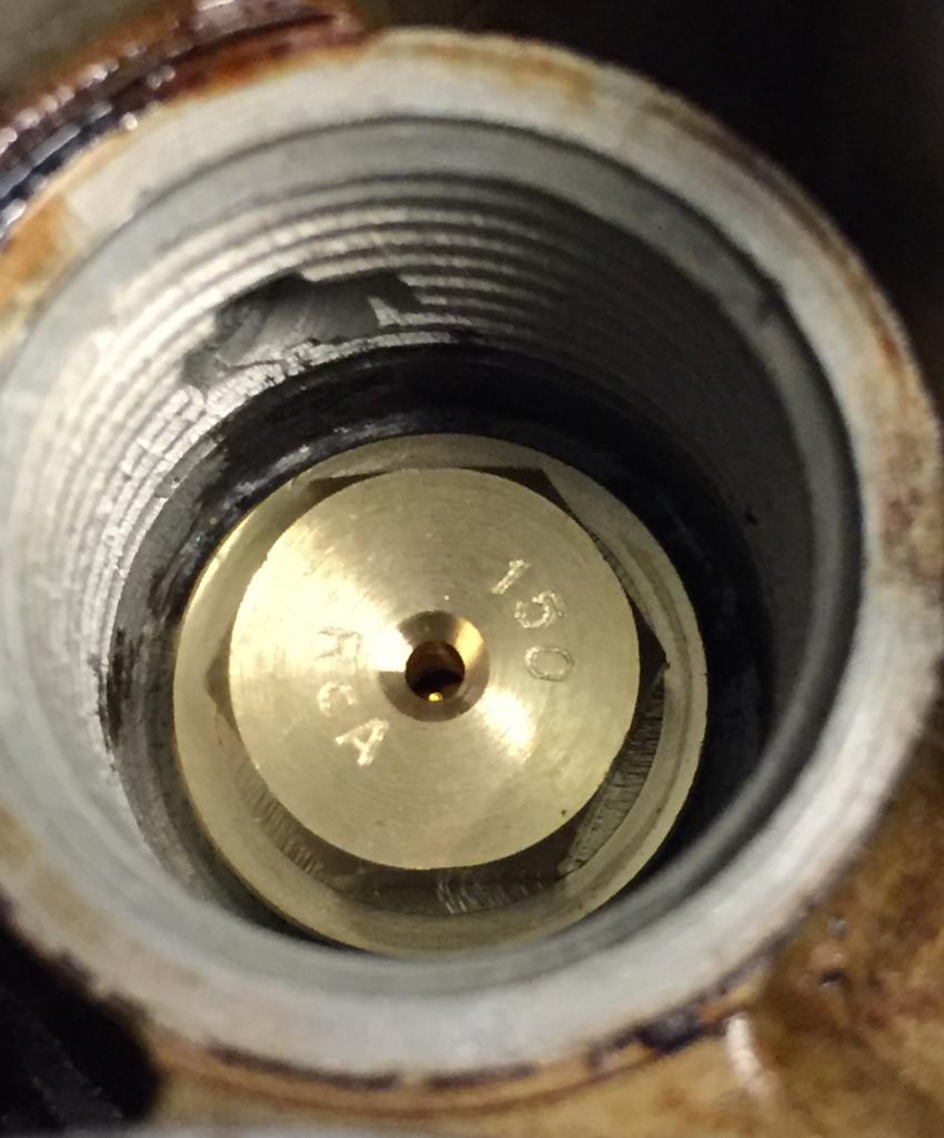

Found the ball that was supposed to be on the spring was missing.
Glad I dug into these Zeniths.
I found a great thread about the Zenith carb being rebuilt on the bird site:
http://forums.pelicanparts.com/porsche-911...by-project.html
I read it about 10 times before I had the nerve to dig in.
