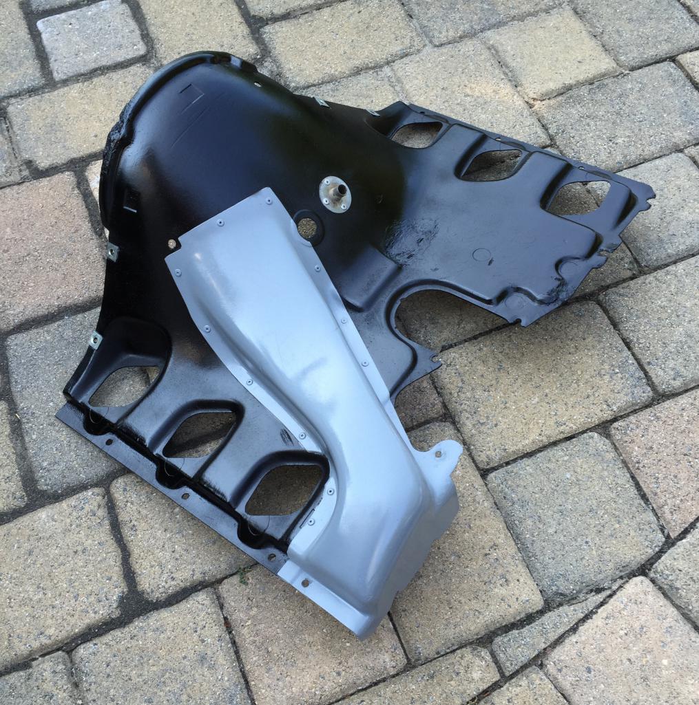

Dion   Replaced the alternator and painted the fan and s...   Feb 5 2017, 10:43 AM
Dion   Shroud   Feb 5 2017, 10:47 AM
Dion   Fan installed   Feb 5 2017, 10:51 AM

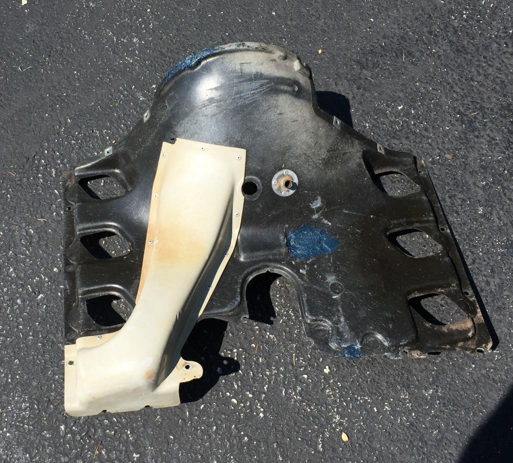

Dion   So the upper valve covers that I did in silver pai...   Feb 5 2017, 11:00 AM
Dion   Put the carbs back on. Added the surrounding sheet...   Feb 5 2017, 11:04 AM
Dion   Engine tin   Feb 5 2017, 11:06 AM
