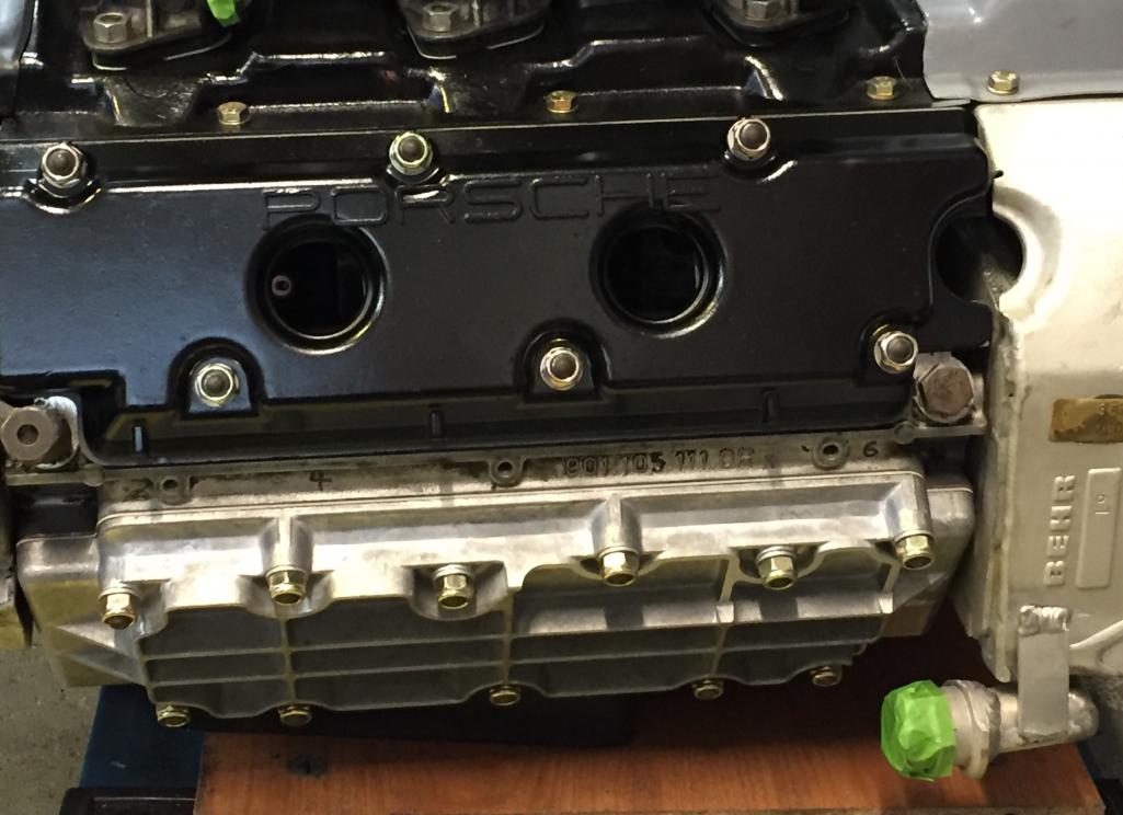

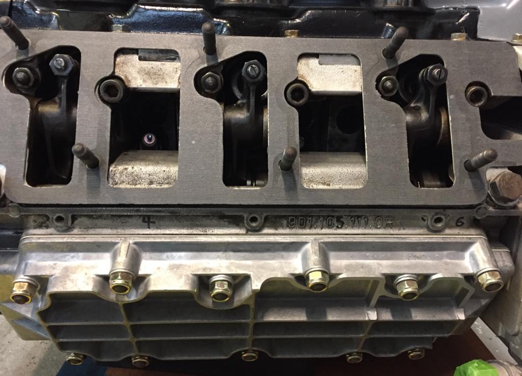

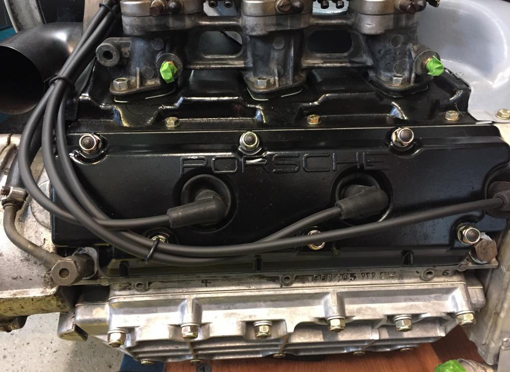

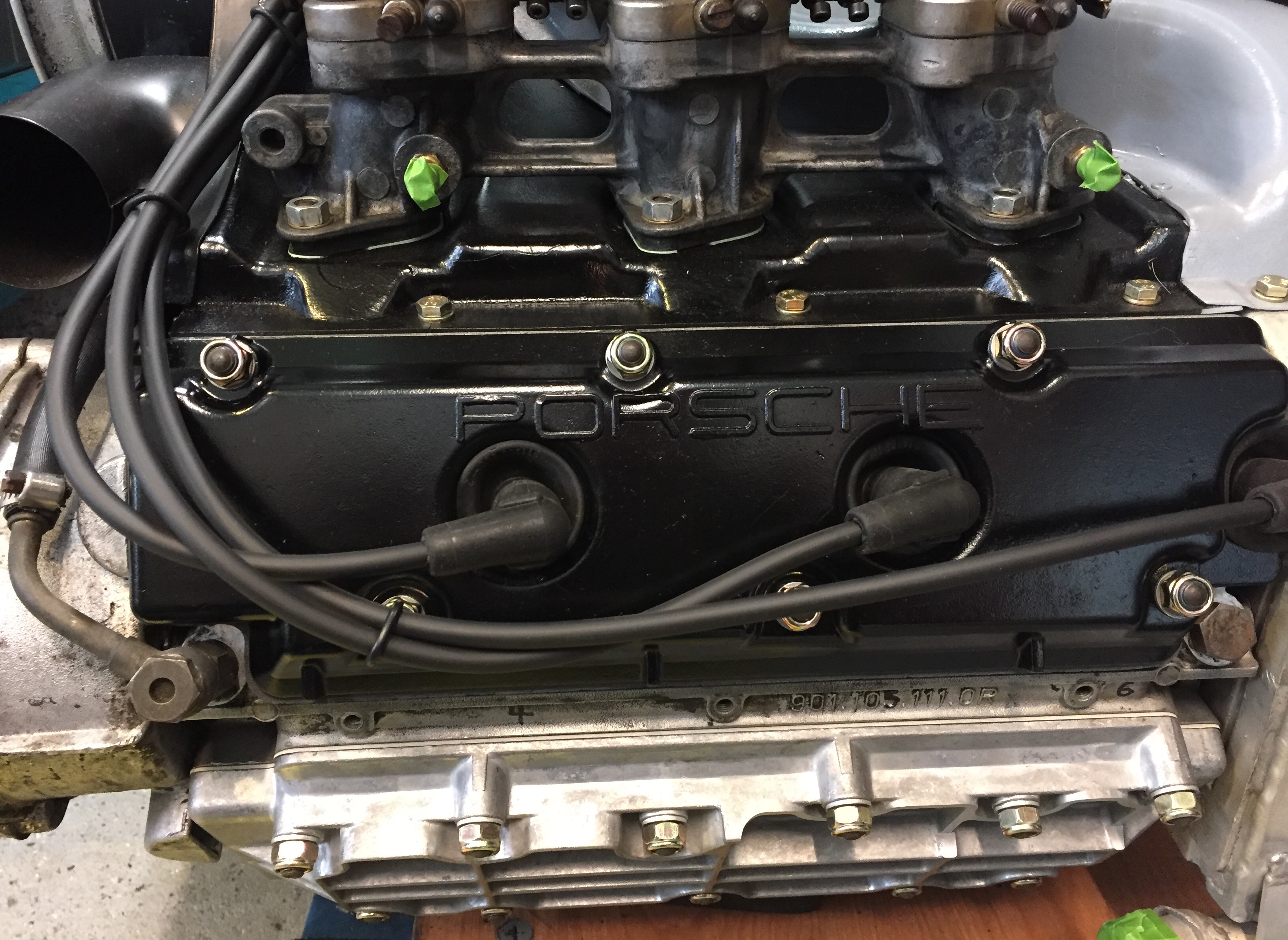

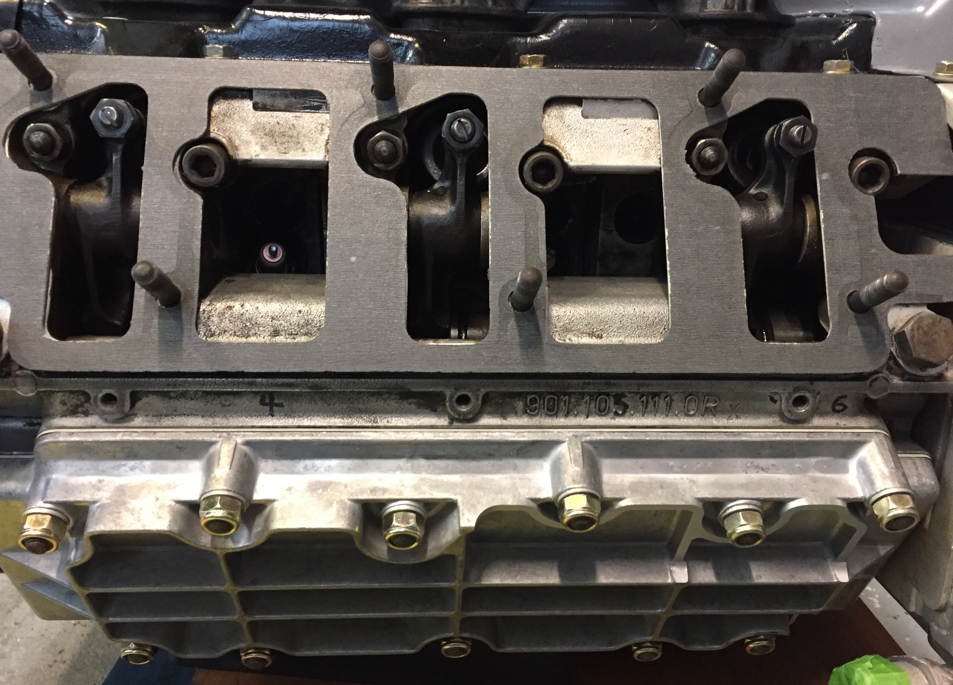

So the upper valve covers that I did in silver paint were done over
in black since the silver didn't adhere very well. Must have had
remnants of oil on them. So after I adjusted the valves this past week
i cleaned the covers up again and did them in black.
Doing the valves with the motor out has to be the way to go.
If you have a lift. It took me over just 2 hours. First time doing a six.
I did it using the standard method as well as the "backside" method mentioned on the
bird site. I prefer the standard method honestly. As I found variations using the backside method. But that's me.
