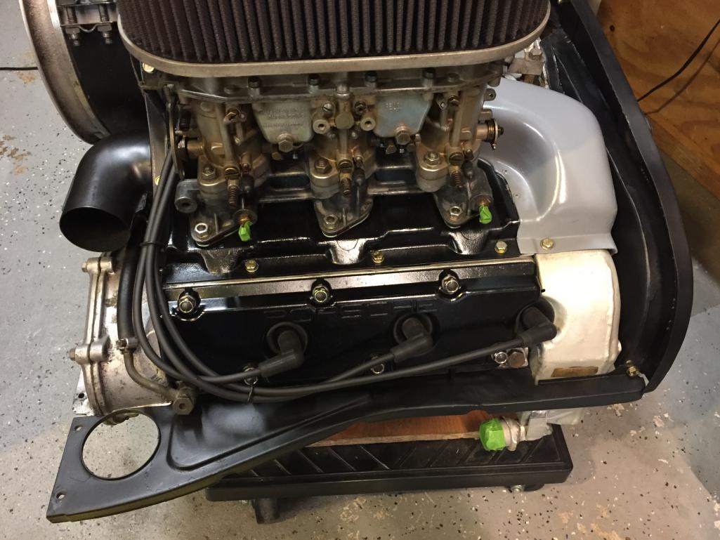

Put the carbs back on. Added the surrounding sheet metal.
Fan side will have to come back off to place motor mount on.
Momentarily felt bad as I had to cut into original 914/6 tin to
Make it fit the 2.4 engine. Oh well. Sorry purists!

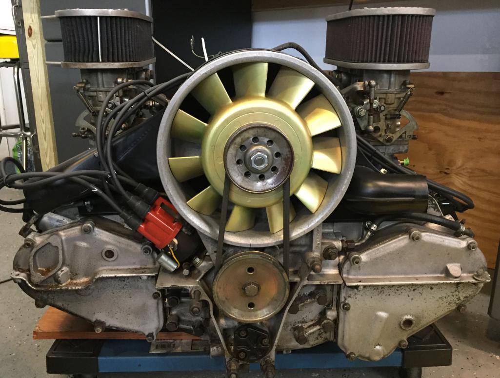

Dion   Bodywork has come full stop for now. Temps are in ...   Feb 5 2017, 10:26 AM
Dion   Took the carbs off for cleaning and replaced all t...   Feb 5 2017, 10:28 AM
Dion   Found the ball that was supposed to be on the spri...   Feb 5 2017, 10:30 AM
Dion   Replaced the alternator and painted the fan and s...   Feb 5 2017, 10:43 AM
Dion   Shroud   Feb 5 2017, 10:47 AM
Dion   Fan installed   Feb 5 2017, 10:51 AM
Dion   So the upper valve covers that I did in silver pai...   Feb 5 2017, 11:00 AM
Dion   Put the carbs back on. Added the surrounding sheet...   Feb 5 2017, 11:04 AM
Dion   Engine tin   Feb 5 2017, 11:06 AM
