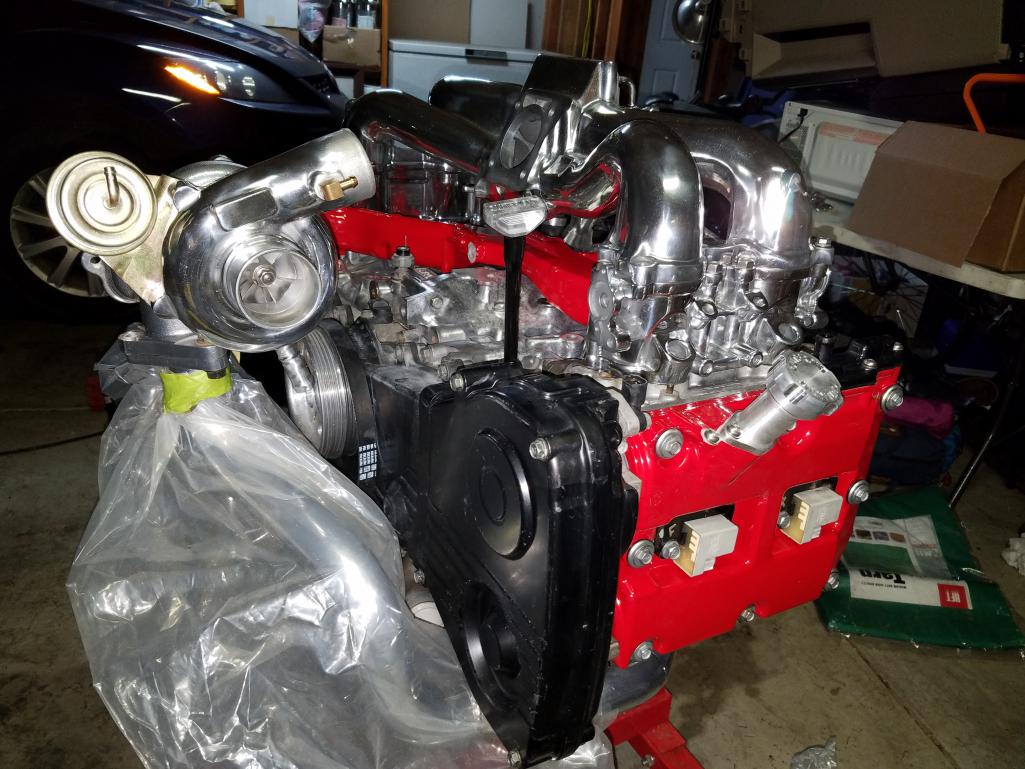

JRust   Got the motor on the stand today. Flipped it over ...   Feb 6 2018, 12:18 AM
76-914   Got the motor on the stand today. Flipped it over...   Feb 6 2018, 11:53 AM
hockeymutt   Got the motor on the stand today. Flipped it over...   Feb 8 2018, 10:35 AM

JRust   Well I had some progress today. I also had a setba...   Feb 10 2018, 06:26 PM
Chris H.   Hmmm...that's weird. Can you post some pics o...   Feb 10 2018, 09:36 PM
JRust   Hmmm...that's weird. Can you post some pics ...   Feb 10 2018, 10:04 PM
Chris H.   Yes the engine sits farther forward with the cradl...   Feb 11 2018, 09:23 AM
JRust   I heard from Brent & he made those tranny hang...   Feb 11 2018, 07:55 PM
