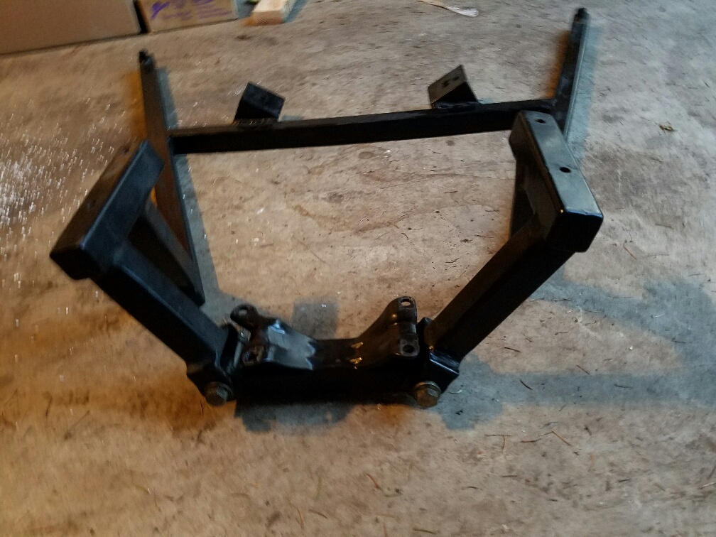

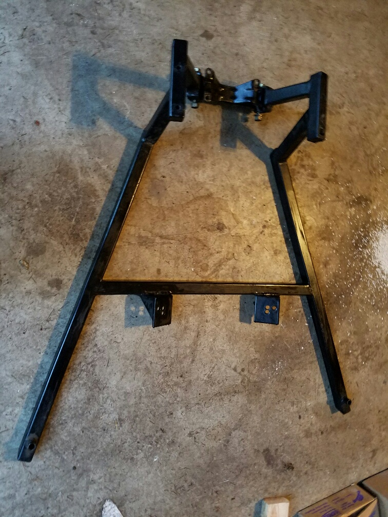

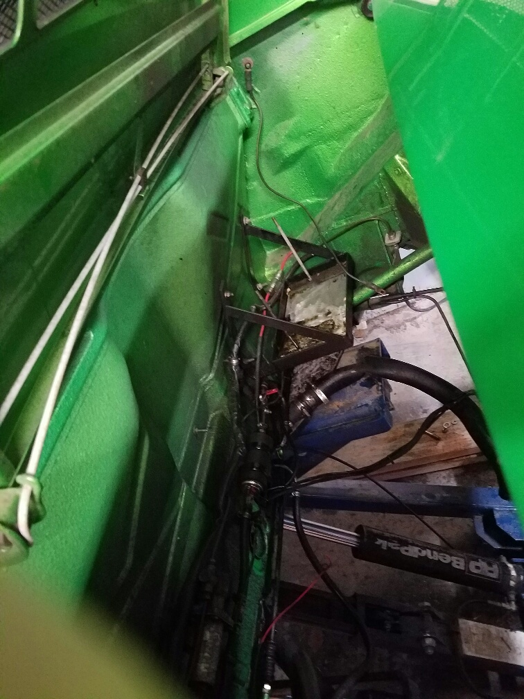

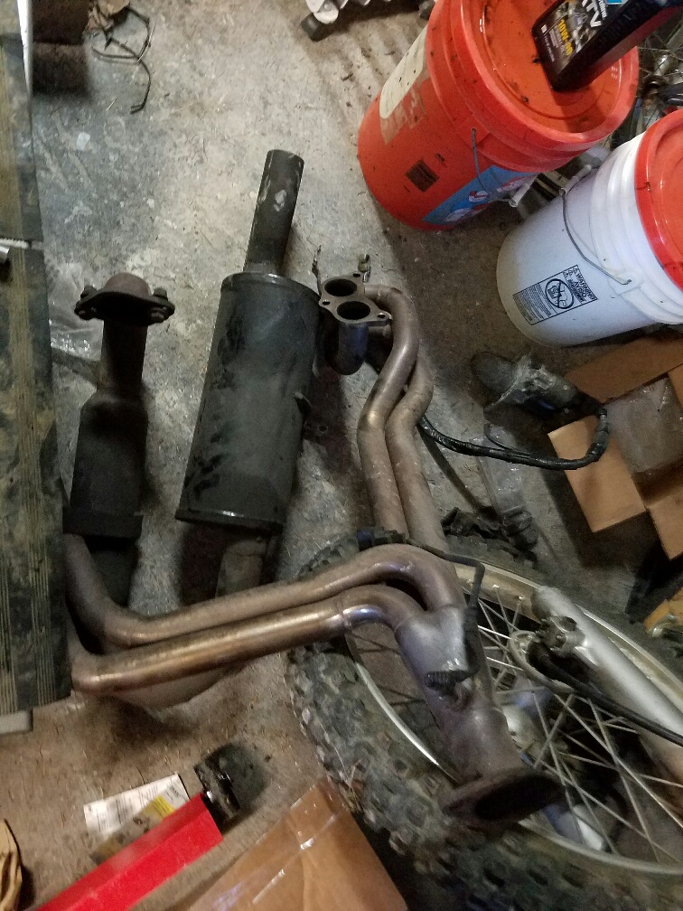

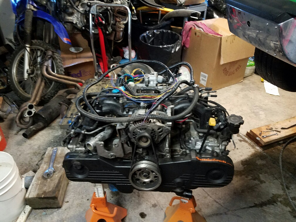

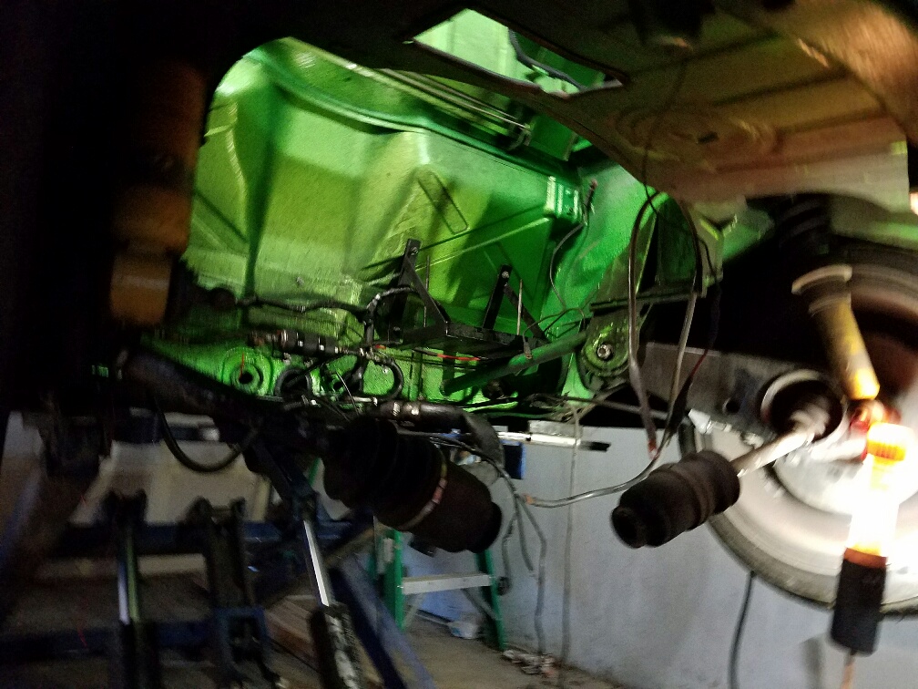

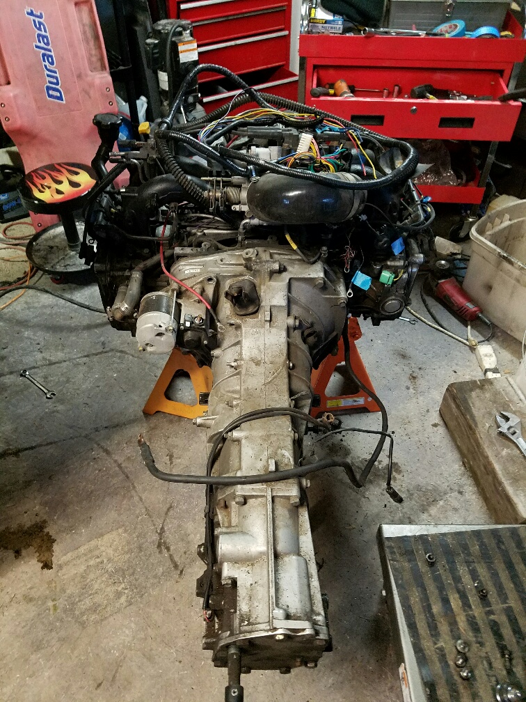

I've got my old drivetrain out! Here are pics of it out off the cradle. I've got an oil pump to replace on my motor that was leaking. So have that to do this week. Cleaning everything up from the oil leak. Then bolting it all back together so it is ready for Rich to bolt right back it. Took me about 3 hours today to do it. Went slow & took more off than needed to get it out. Taking lots of pics as I go. Marking all the wires & what connected where. Managed to pull one sensor to my gauges out. just the wires about half way. Easy fix just missed it & pinched it when I pulled the motor. Guess it wouldn't be a motor pull without me missing at least one wire (IMG:style_emoticons/default/rolleyes.gif)
