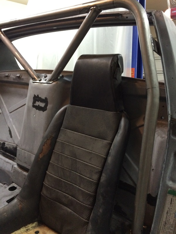

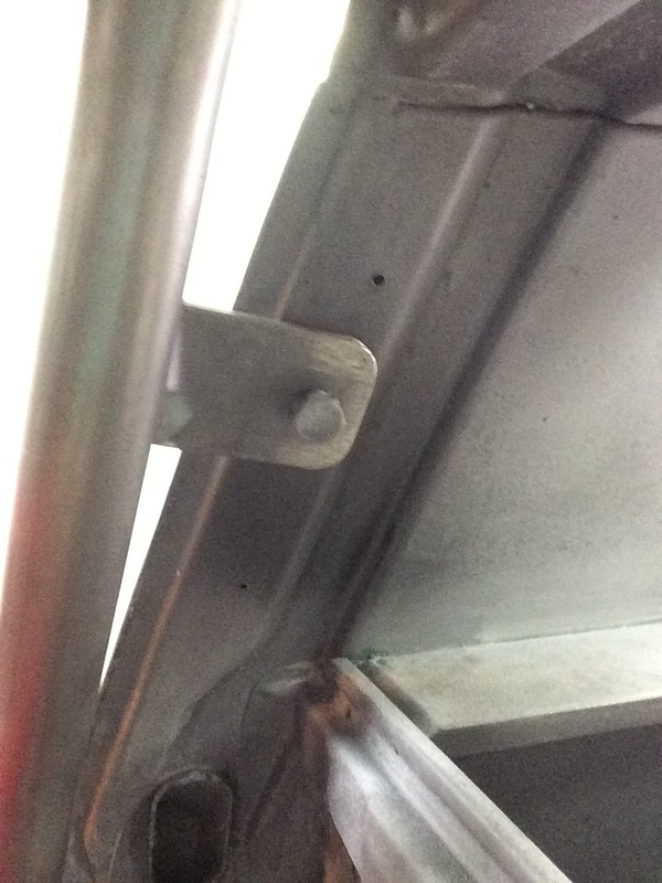

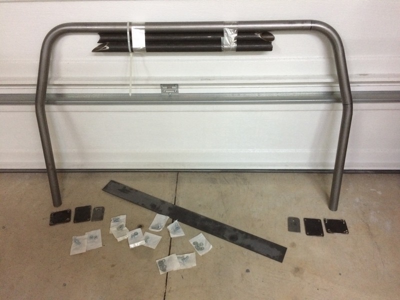

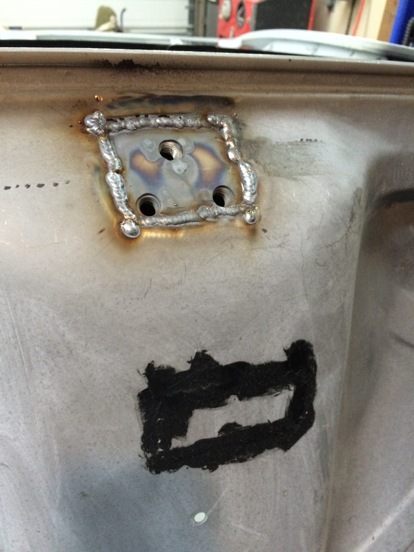

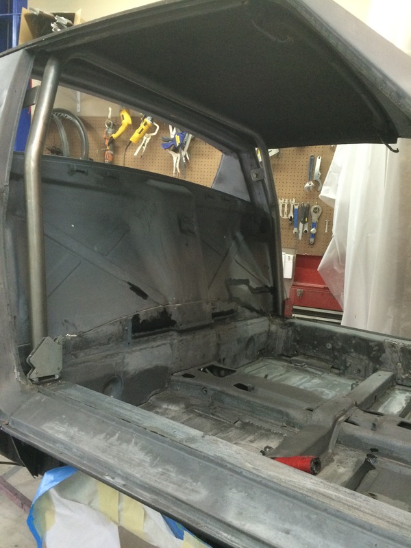

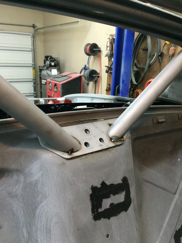

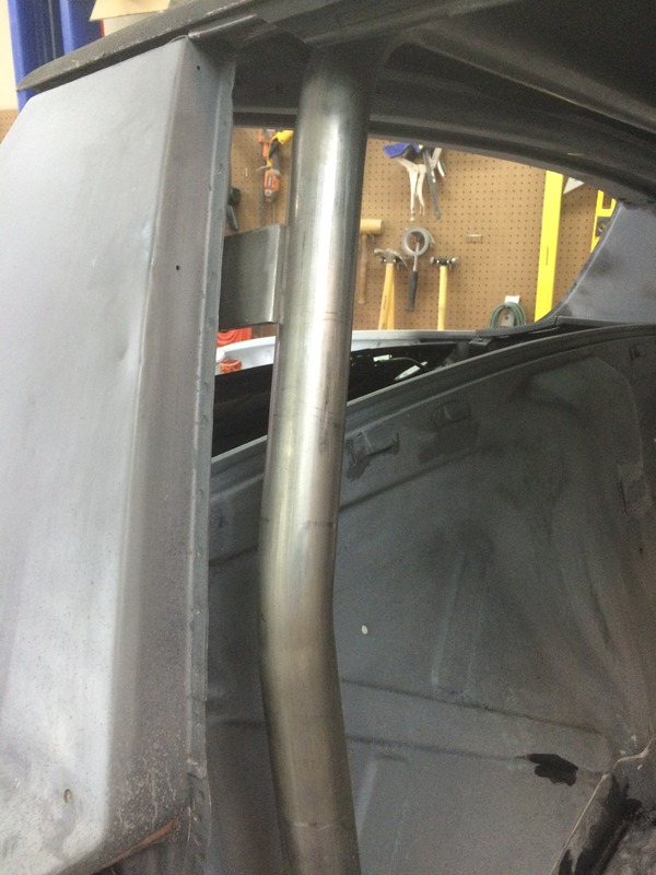

And, well......I couldn't leave well enough alone. The more I work on this chassis, the closer it gets to a GT replica, so I decided to add a bolt-in rollcage similar to the factory cars. Ordered a hoop and baseplates from Chris at Tangerine Racing. The fit was perfect. Not a centimeter to tall. I can still latch the targa top with the rollbar in place. Nice job Chris!!
(IMG:http://www.914world.com/bbs2/uploads_offsite/i75.photobucket.com-18986-1487043524.1.jpg)
(IMG:http://www.914world.com/bbs2/uploads_offsite/i75.photobucket.com-18986-1487043524.2.jpg)
(IMG:http://www.914world.com/bbs2/uploads_offsite/i75.photobucket.com-18986-1487043524.3.jpg)
(IMG:http://www.914world.com/bbs2/uploads_offsite/i75.photobucket.com-18986-1487043525.4.jpg)
(IMG:http://www.914world.com/bbs2/uploads_offsite/i75.photobucket.com-18986-1487043525.5.jpg)
(IMG:http://www.914world.com/bbs2/uploads_offsite/i75.photobucket.com-18986-1487043525.6.jpg)
(IMG:http://www.914world.com/bbs2/uploads_offsite/i75.photobucket.com-18986-1487043525.7.jpg)
