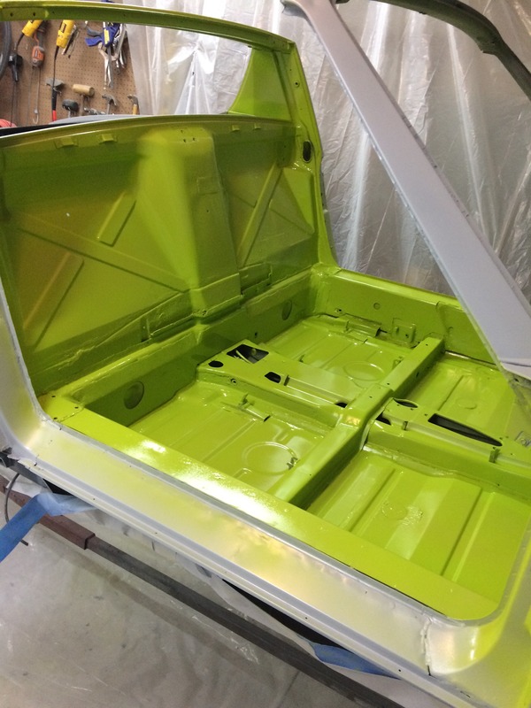

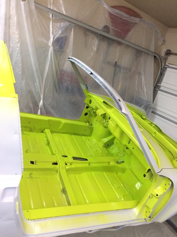

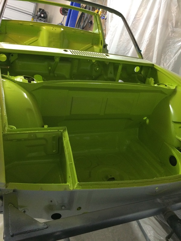

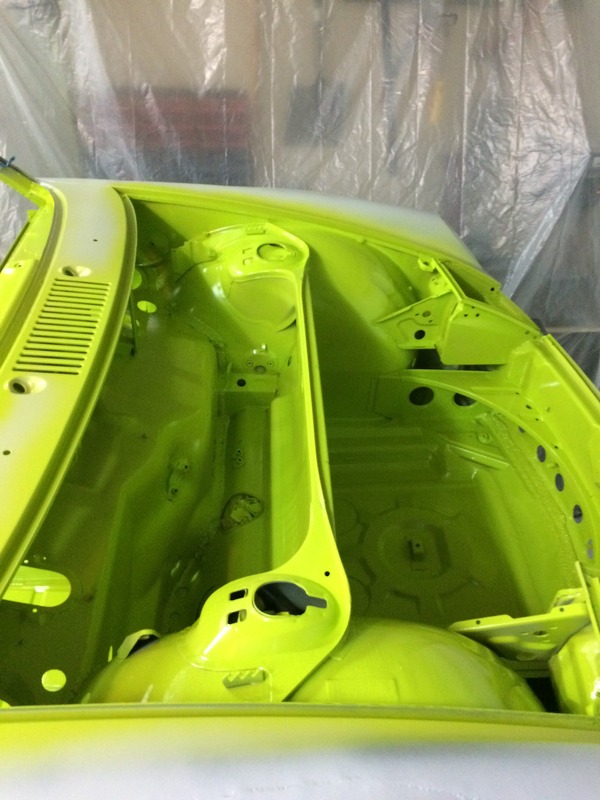

YES!! Finally got some color and clearcoat on the interior and front trunk!! Ravenna Green (IMG:style_emoticons/default/biggrin.gif)

Next is the exterior bodywork, final paint, and reassembly (IMG:style_emoticons/default/beerchug.gif)
