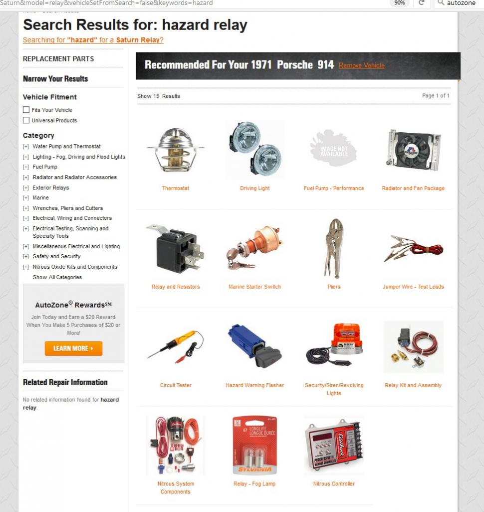

QUOTE(vin man @ Feb 15 2017, 01:32 PM) *
Autozone also has one. This is the one from Autozone: Autozone Flasher Relay
Did you try re-installing your original flasher. Quite honestly the flasher does very little besides flash when you put the turnsignals on. If your original flasher flashes the exterior bulbs ok, there is nothing wrong with the flasher. Likely you have some wiring issue external to the flasher.
The link above takes me to partsgeek.
Autozone doesn't list a flasher or hazard relay for the 914 although it has some other interesting items for the 914.
I was wondering why my 914 is so slow. Maybe I need a new Nitrous Controller. (IMG:style_emoticons/default/av-943.gif)
