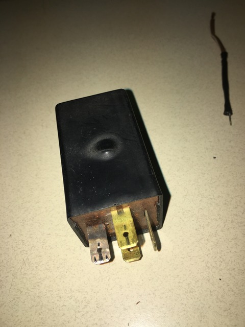

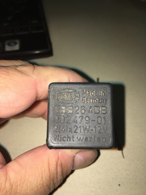

The first is the original relay that smoked. Part number on the relay is TBB264DB 002479-01
(IMG:http://www.914world.com/bbs2/uploads_offsite/i304.photobucket.com-11380-1487212504.1.jpg)
(IMG:http://www.914world.com/bbs2/uploads_offsite/i304.photobucket.com-11380-1487212504.2.jpg)

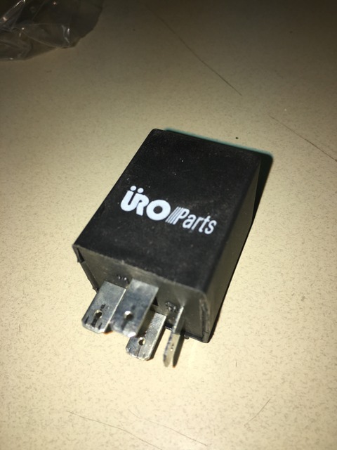

The next relay is the one from Autozone. p/n 91461830311E
(IMG:http://www.914world.com/bbs2/uploads_offsite/i304.photobucket.com-11380-1487212505.3.jpg)

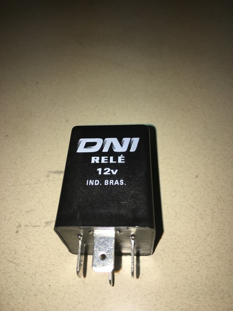

Finally the one from BAP/Parts Authority. DNI 0831/41
(IMG:http://www.914world.com/bbs2/uploads_offsite/i304.photobucket.com-11380-1487212505.4.jpg)
