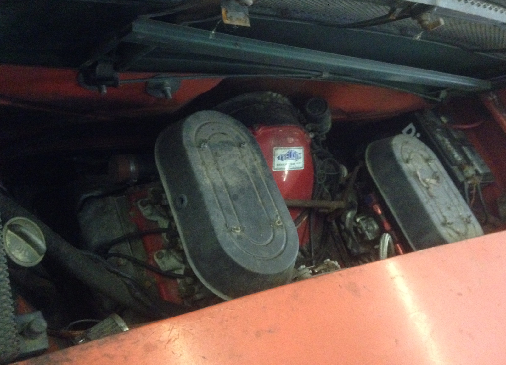

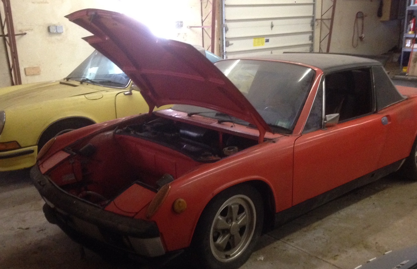

A very good friend on mine scored what I think could be deal of the century. He is a VW collector and has restored/modified many air cooled VW's over the years. He is not that familiar with Porsches and has asked me to give him advise as to what he has purchased and what he should do with it.
I got a call this past Sunday that he purchased a Porsche 914- 6 from an estate for $1000.00 !!! Of course, the first question I asked was what the serial number was to determine if it was a real "6". Turns out that it was a '74 converted to a "6". From the pictures it looks like it has an early naturally aspired 911 motor. My question is where is the serial number on the motor? We are curious as to how old the motor is and determine what the displacement could be. The motor does turn and there is no outward signs of rust including the Hell Hole.
Tomorrow I will accompany him to inspect further and take some more pictures. I would like to find the engine number at that time.

db9146   You can find the engine # on a 911 engine to the r...   Feb 6 2017, 09:27 AM
dcheek   You can find the engine # on a 911 engine to the ...   Feb 6 2017, 09:31 AM
tomeric914   Will I have to remove the right air cleaner? Nop...   Feb 6 2017, 09:51 AM

RobW   You can use your iPhone to take a picture of it. L...   Feb 6 2017, 12:41 PM
Larmo63   The type of motor is located facing up close behin...   Feb 6 2017, 12:56 PM
mepstein   The type of motor is located facing up close behi...   Feb 6 2017, 02:17 PM
rgalla9146   The serial number is on the drivers side of the fa...   Feb 6 2017, 02:36 PM
malcolm2   Google it.... "911 engine number location...   Feb 6 2017, 02:53 PM
timothy_nd28   What does the green arrow mean? :confused:   Feb 6 2017, 03:32 PM
malcolm2   What does the green arrow mean? :confused: I c...   Feb 6 2017, 03:39 PM

Luke M   Nice score... looks like a MFI engine see the pic....   Feb 7 2017, 01:30 PM

dcheek   Picked up the car today (finally). It has fibergla...   Feb 14 2017, 02:53 PM
billh1963   The engine number is 46122821. I thought all 6 c...   Feb 14 2017, 03:07 PM
defianty   The engine number is 46122821. I thought all 6 c...   Feb 14 2017, 03:51 PM
dcheek   The engine number is 46122821. I thought all 6 ...   Feb 15 2017, 06:38 AM
mountainroads   The engine number is 46122821. I thought all 6 ...   Feb 15 2017, 10:12 AM
flyer86d   [quote name='defianty' post='2454639' date='Feb 1...   Feb 15 2017, 10:39 AM
mountainroads   [quote name='defianty' post='2454639' date='Feb ...   Feb 15 2017, 10:42 AM
Mike Fitton   Post a picture of the engine number it does not st...   Feb 15 2017, 07:49 AM
defianty   There should be an engine type number stamped too ...   Feb 15 2017, 08:14 AM

dcheek   Spent all day today vacuuming and powerwashing. Go...   Feb 19 2017, 02:52 PM

dcheek   The Cleanup. Rear trunk no rust Front trunk no ru...   Feb 20 2017, 02:48 PM
