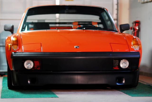

Here's the old ad for the car.
http://www.914world.com/bbs2/index.php?sho...=104679&hl=

mepstein   Here's the old ad for the car. http://www.91...   Feb 18 2017, 06:52 AM
