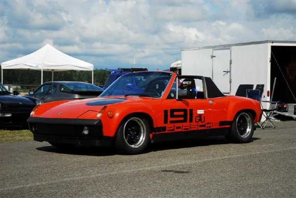

mepstein   Here's the old ad for the car. http://www.91...   Feb 18 2017, 06:52 AM

rhodyguy   After the Washington build comment it was pretty e...   Feb 19 2017, 11:41 AM

jmill   OMG! WTF! That was my all time favorite ...   Feb 19 2017, 03:02 PM
