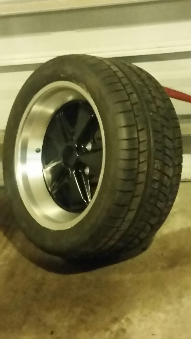

Euromeisters were too good of a deal to pass up, right?!
tazz9924
post Feb 25 2017, 07:22 PM
Posts: 755
Joined: 31-May 15
From: Mooresville NC
Member No.: 18,779
QUOTE(mgp4591 @ Feb 25 2017, 04:27 PM) *
No!......... yes..136$ per rim
mgp4591
post Feb 26 2017, 12:49 AM
Posts: 6,057
Joined: 1-August 12
From: Salt Lake City Ut
Member No.: 14,748
QUOTE(tazz9924 @ Feb 25 2017, 06:22 PM) *
I'm guilty as well - even the same size but I went 275/40.... probably overkill but eh, why not?! (IMG:style_emoticons/default/shades.gif)Attached Image
tazz9924
post Feb 26 2017, 10:14 AM
Posts: 755
Joined: 31-May 15
Member No.: 18,779
QUOTE(mgp4591 @ Feb 25 2017, 10:49 PM) *
it would b cool yo fit 275s rear but for me i just don't see that much space a 255 is as big as im comfortable however with modifications i could see 275.
