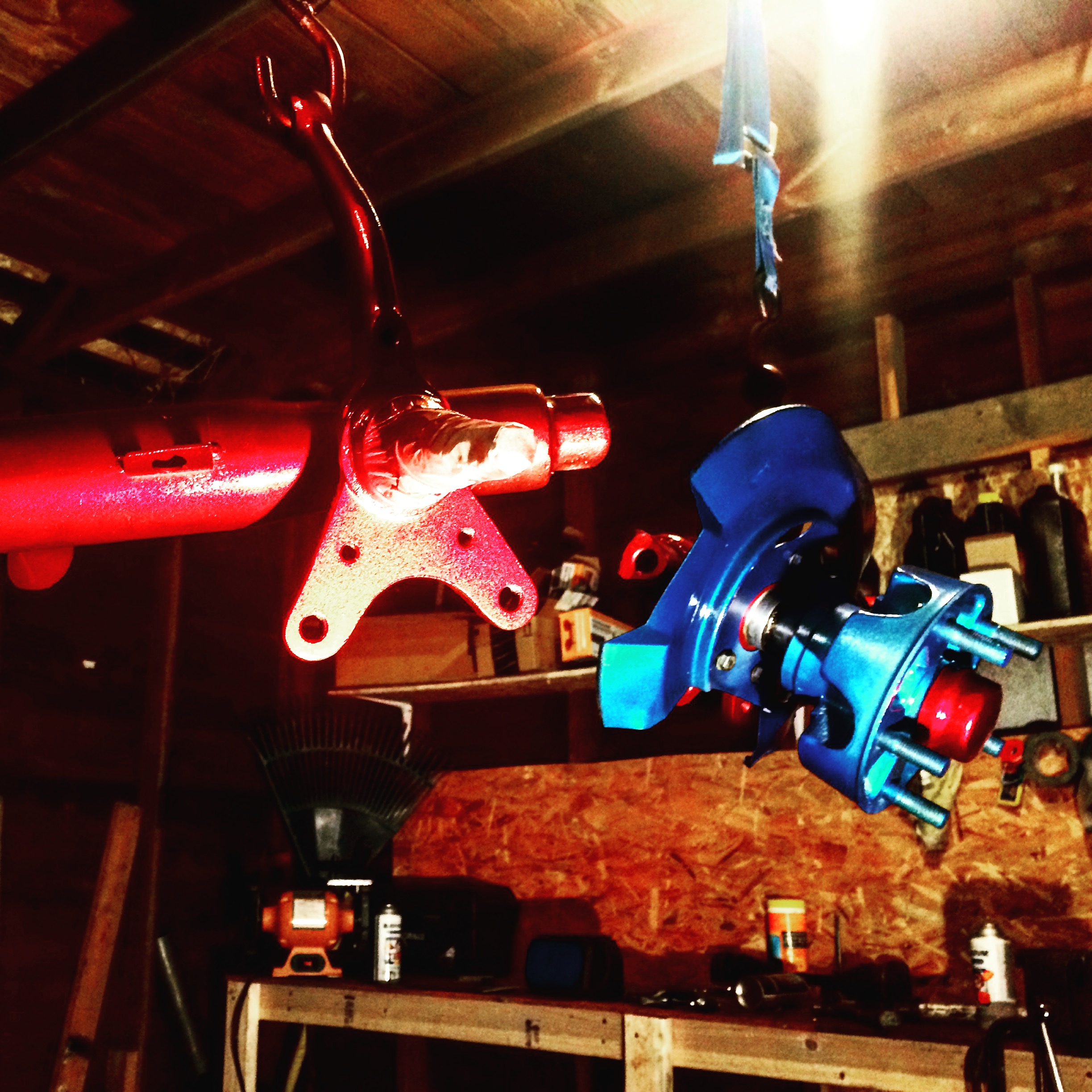

gotta throw some 911 struts on the front first their gonna b put on soon till then here's a teaser

tazz9924   Im finally ditching the ill fitting revolution whe...   Feb 25 2017, 04:06 PM
mgp4591   Euromeisters were too good of a deal to pass up, r...   Feb 25 2017, 06:27 PM
tazz9924   Euromeisters were too good of a deal to pass up, ...   Feb 25 2017, 07:22 PM
mgp4591   Euromeisters were too good of a deal to pass up,...   Feb 26 2017, 12:49 AM
tazz9924   [quote name='tazz9924' post='2458295' date='Feb 2...   Feb 26 2017, 10:14 AM
JRust   Yes let's see those bad boys on your car :droo...   Feb 26 2017, 03:45 PM
tazz9924   Yes let's see those bad boys on your car :dro...   Feb 26 2017, 04:17 PM
