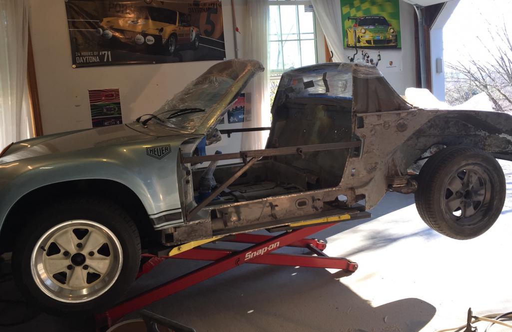

Dion   Some garage time this afternoon. Started prepping ...   Jan 26 2017, 04:23 PM
Dion   Also some body filler escaped proper contouring fr...   Jan 26 2017, 04:27 PM
Dion   Hammered.   Jan 26 2017, 04:27 PM

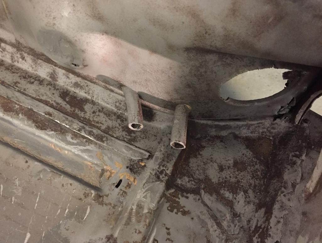

Dion   Curious? Anyone have a "proper" hole on ...   Jan 26 2017, 04:31 PM
altitude411   Curious? Anyone have a "proper" hole on...   Jan 26 2017, 04:49 PM
Dion   Tow hook spot?   Jan 26 2017, 04:32 PM
914dave   Mine has the same hole. No idea what it's for.   Jan 26 2017, 04:49 PM
tom.esh   My replacement pan has that hole. I don't thin...   Jan 26 2017, 06:29 PM

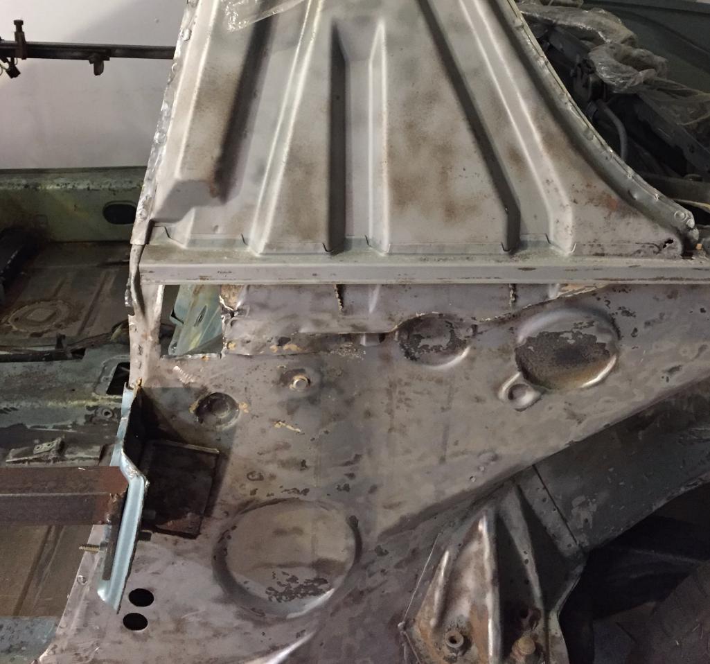

Dion   Weather finally gave me a window to sandblast the ...   Feb 28 2017, 11:37 AM
Dion   Sandblasted   Feb 28 2017, 11:39 AM
Dion   Cut out the firewall to make my life easier in the...   Feb 28 2017, 11:44 AM
