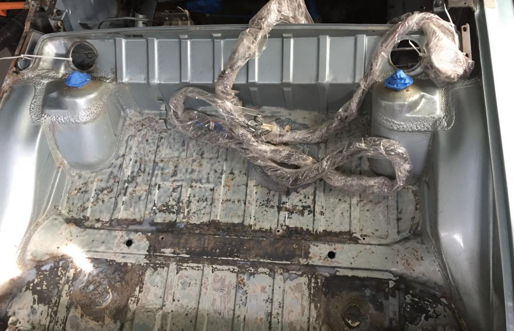

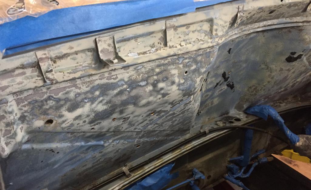

Dion   Weather finally gave me a window to sandblast the ...   Feb 28 2017, 11:37 AM
Dion   Sandblasted   Feb 28 2017, 11:39 AM
Dion   Cut out the firewall to make my life easier in the...   Feb 28 2017, 11:44 AM
