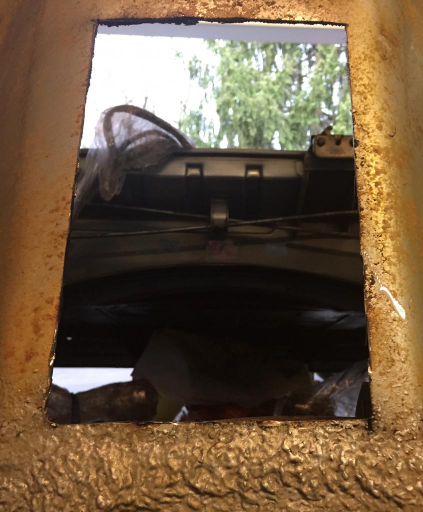

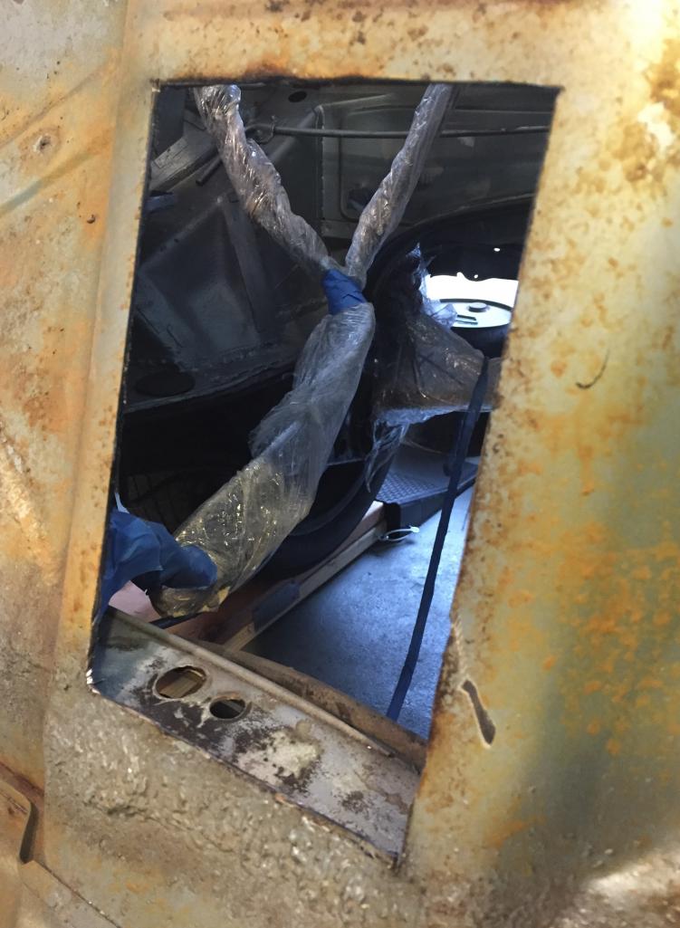

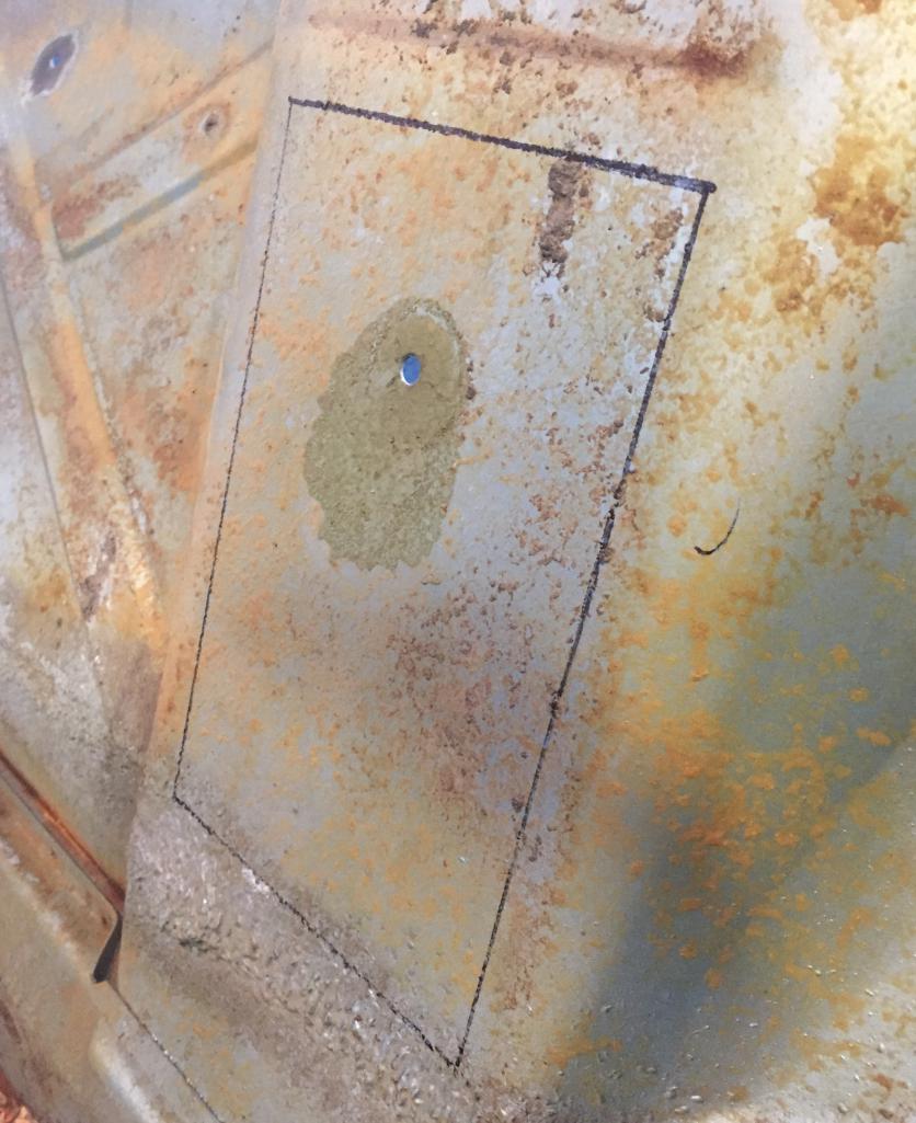

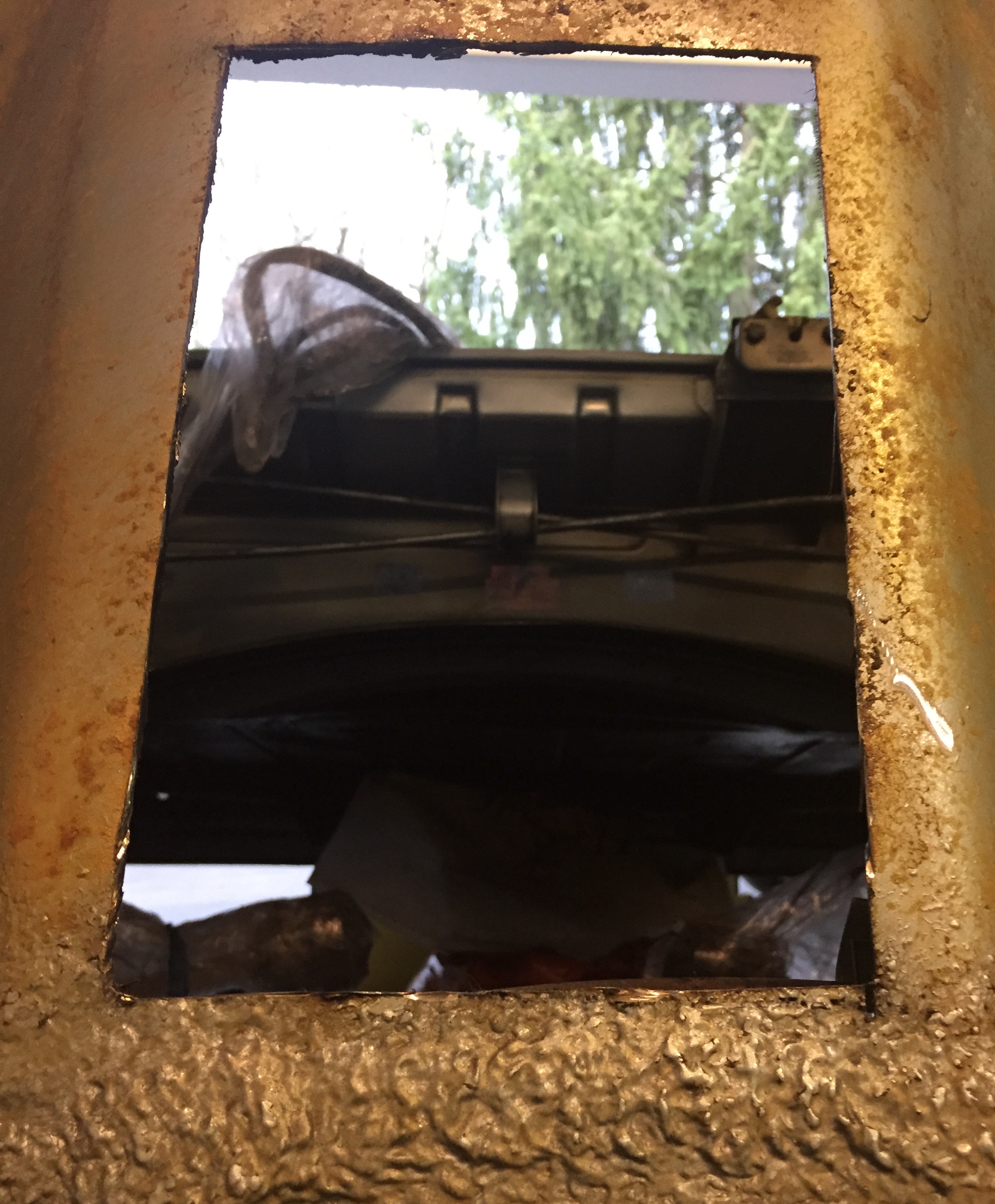

Cut out the firewall to make my life easier in the future.
I know there's plenty of opinions on this.
Rest assured it will be covered with a steel door made from another
firewall courtesy of Garold. I will be welding nuts to engines side to secure it. Add appropriate rubber seals,etc.
That's a way down the list. Nevertheless that's the plan
