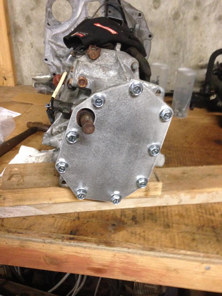

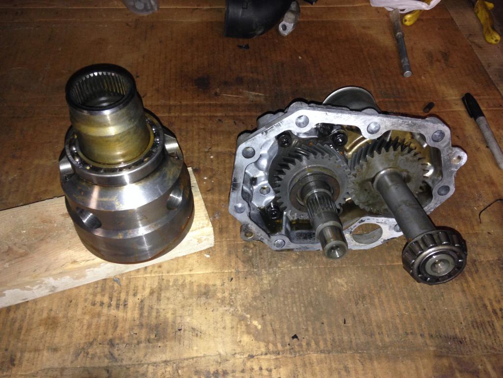

Pictures of Ross's blockoff plate and the removed pieces. I found a bad center diff locally and bought it to cut apart. Its now taken apart and the plan is to get it cut this week and then pull the nut off the gear stack and do some measuring. Before welding I'm going to turn some alignment pins to keep everything concentric.

jd74914   Pulled apart bad center diff ready for cutting.   Mar 1 2017, 12:54 PM
