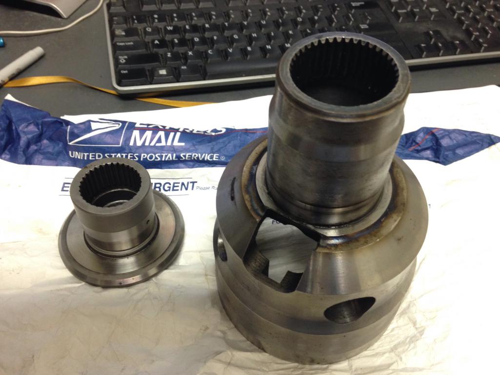

Pulled apart bad center diff ready for cutting.

jd74914   Working really slowly this month...too much other ...   Mar 1 2017, 12:54 PM
jd74914   Pulled apart bad center diff ready for cutting.   Mar 1 2017, 12:54 PM
jd74914   Cut up the differential last night and test fit in...   Mar 10 2017, 09:53 AM
jd74914   Crudely filed housing splines. You can see where i...   Mar 10 2017, 09:57 AM
jd74914   Of course it wouldn't slide out of the differe...   Mar 10 2017, 10:04 AM
