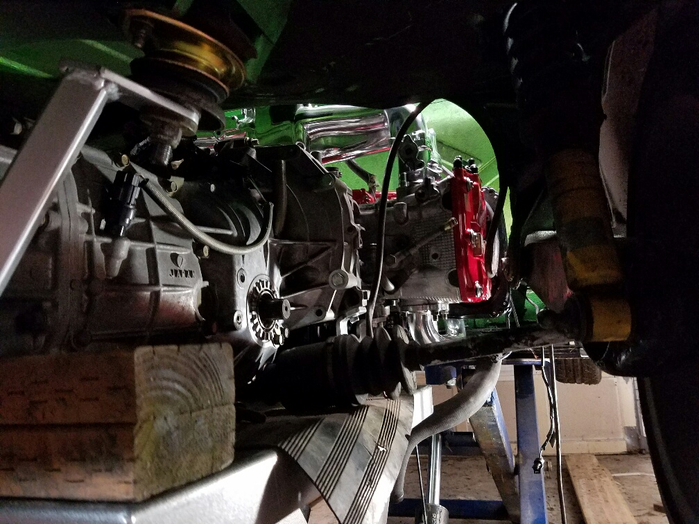

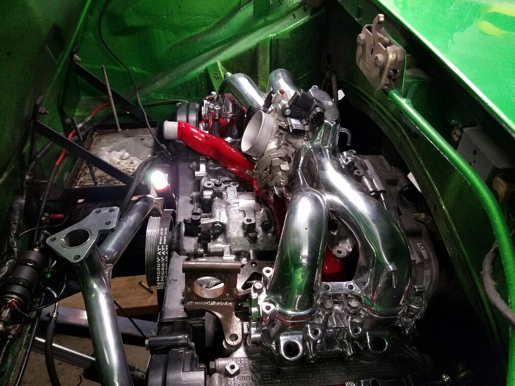

Okay a little progress. Took a me a bit but I got my old drivetrain shipped off to Rick. Bolted up my tranny to my new motor. Wanted to do a little test fitting tonight. With my tranny hangar's bolted to the tranny. I bolted the rear in place. My header is just hitting my battery mount which is lower on the firewall. I think it will still work there. Just may need to be unbolted & then put back on with my motor is in place. Probably the least of my worries at this point.
A few years ago when I was working on a subaru conversion before buying this one. I was using a 901 with an adapter plate to the motor I had. I had a small car mount on the suby motor with a tab welded on the front. It joined the mount in front & gave a nice flat surface. I was able to use an early stock 914 engine bar as well as the rubber motor mounts. I am looking to do something similar here. My small car mount sits pretty level with my headers. My shortened oil pan sits about an inch & a half below these headers. Using a stock engine bar it will sit level with my oil pan. Just need to add a piece to the small car mount that will let it mount on the engine bar. I'll post some pics when I've got it done. For anyone running the headers out back this would work even better.

JRust   Okay a little progress. Took a me a bit but I got ...   Mar 3 2017, 12:24 AM
JRust   Did a little more test fitting. With the tranny ha...   Mar 9 2017, 09:12 PM
Chris914n6   http://www.914world.com/bbs2/uploads/post-129-148...   Mar 9 2017, 11:04 PM
JRust   Flip the mount and assemble it correctly :poke: ...   Mar 10 2017, 12:02 AM

Andyrew   I think you should triangulate those rear trani mo...   Jul 20 2017, 01:27 PM
