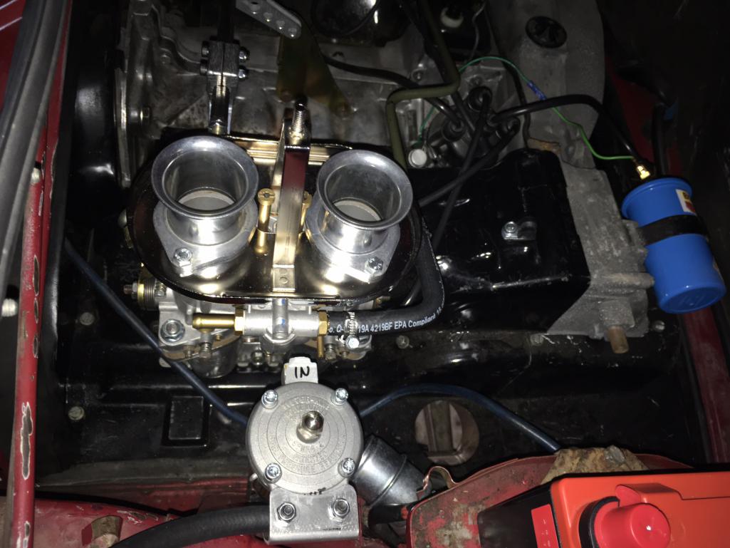

Been doing work on the car but not posting progress, so I'll have to start doing that. Rebuilt the Webers, they are basically in new condition now. There's a new steel fuel line in, rotary fuel pump and fuel pressure regulator. The engine sounds pretty good, but there's a huge oil leak so the motor is coming out for a refresh. I have decided to sell these carbs (40's) because I got a larger brand new pair to take their place.

stanthedog   How do carbs work compared to stock FI? Just curio...   Mar 5 2017, 03:52 PM
mtndawg   How do carbs work compared to stock FI? Just curi...   Mar 5 2017, 05:13 PM
zambezi   Larger carbs? How big is your motor?   Mar 5 2017, 04:46 PM

Dave_Darling   44s are very likely going to be too much carb for ...   Mar 6 2017, 05:11 PM
