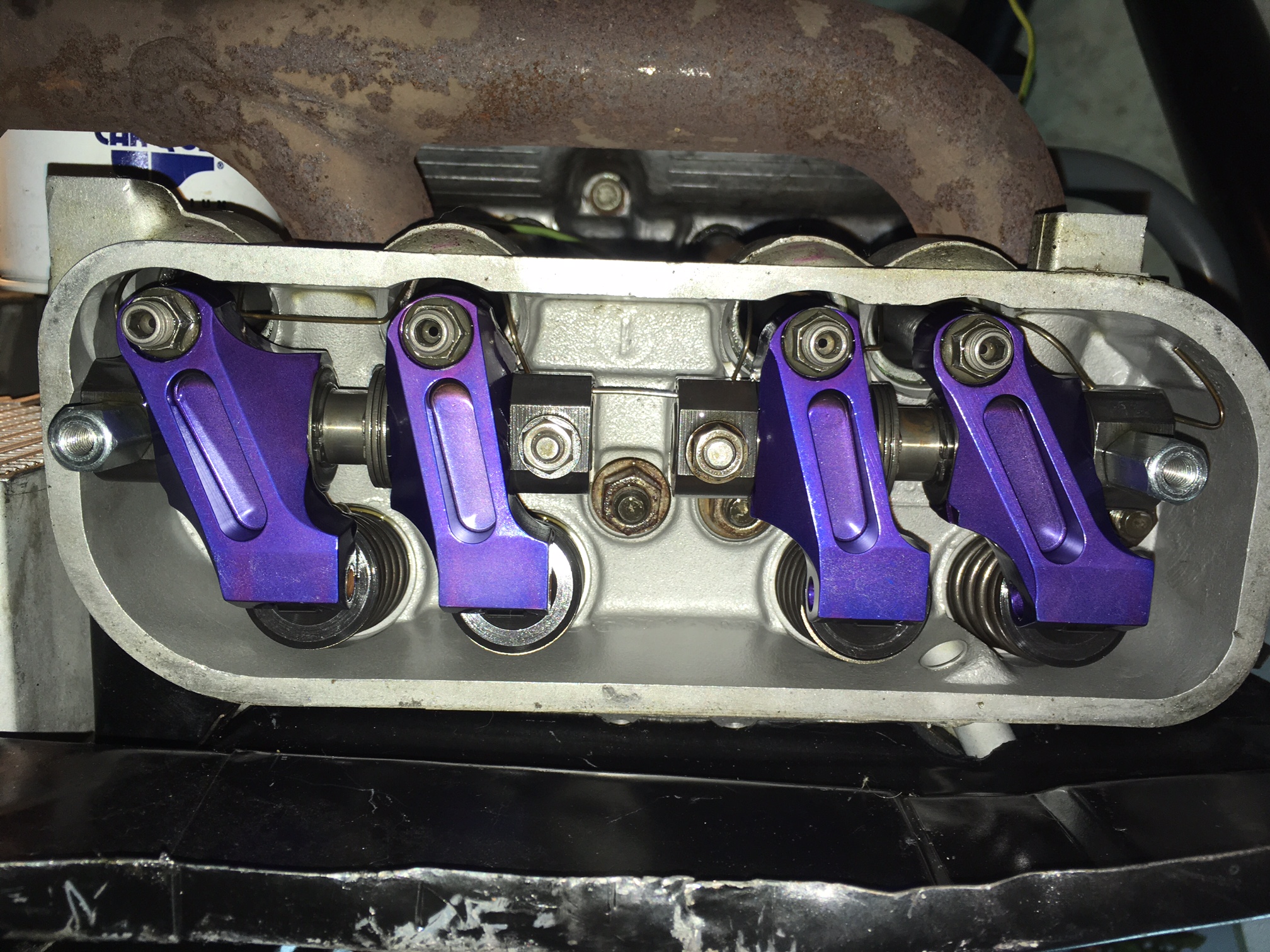

Engine was dropped. Here's a photo of the Pauter Rockers that are going to be replaced by 1.7 rockers with the elephant foot adjuster.
I'm going to put 44 Webers on. Someone in the past enlarged the engine beyond 2.0. I need to get the cylinder measurements to know the exact size.

Dave_Darling   44s are very likely going to be too much carb for ...   Mar 6 2017, 05:11 PM
bretth   Why remove the Pauter rockers? Are they worn or to...   Mar 6 2017, 10:01 PM
Dave_Darling   Why remove the Pauter rockers? Are they worn or to...   Mar 7 2017, 03:48 PM

Dougster   Why remove the Pauter rockers? Are they worn or t...   Apr 4 2018, 09:32 PM
jcd914   [quote name='Dave_Darling' post='2461584' date='M...   Apr 4 2018, 10:09 PM
Dave_Darling   It's not that 2.0 rockers don't need machi...   Apr 4 2018, 10:12 PM
mtndawg   Yes the 911 lug fits into the 1.7 rocker it does n...   Apr 4 2018, 10:15 PM

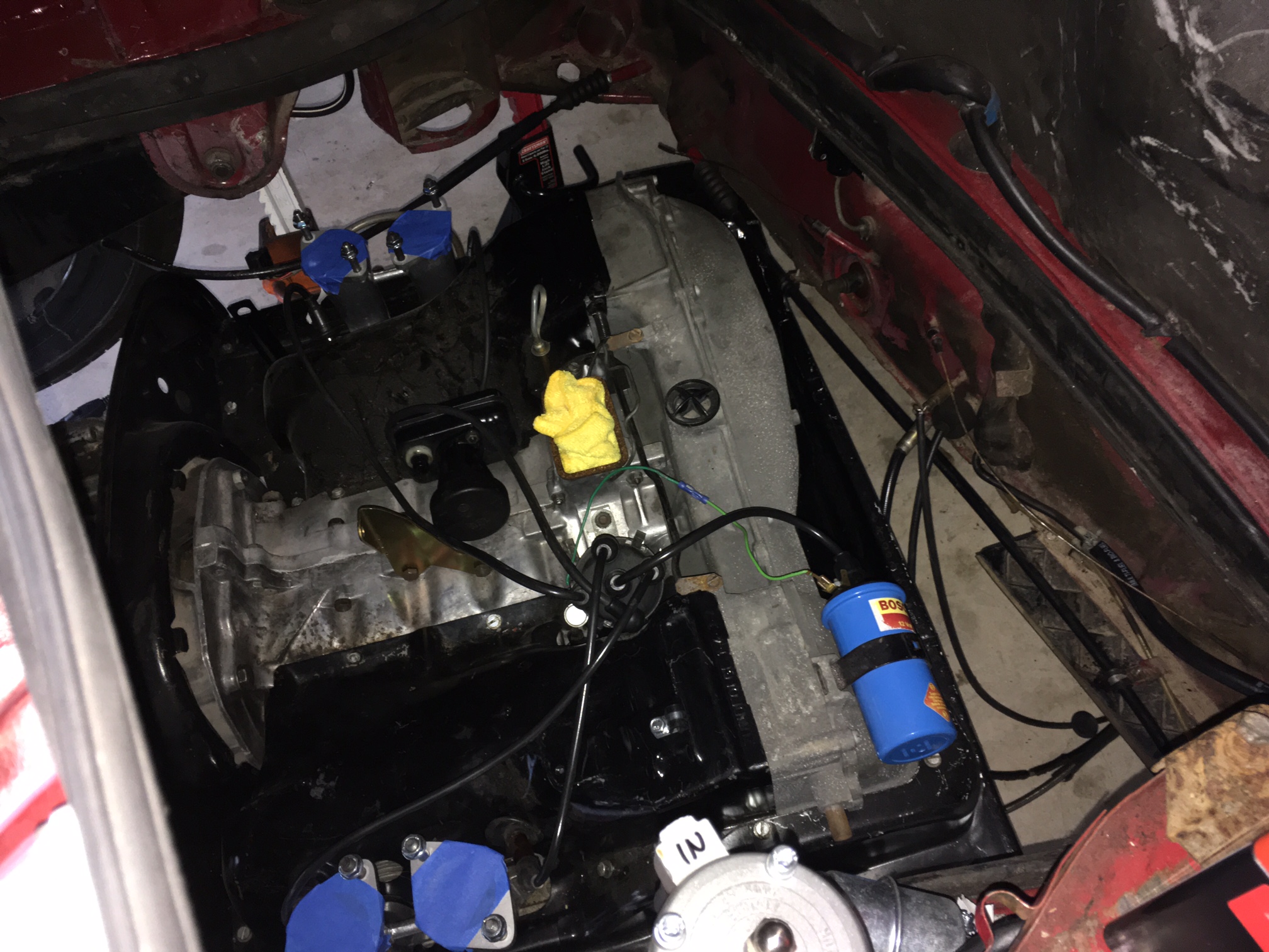

mtndawg   Here's are photos of the finished engine bay, ...   Jan 15 2020, 04:42 PM
