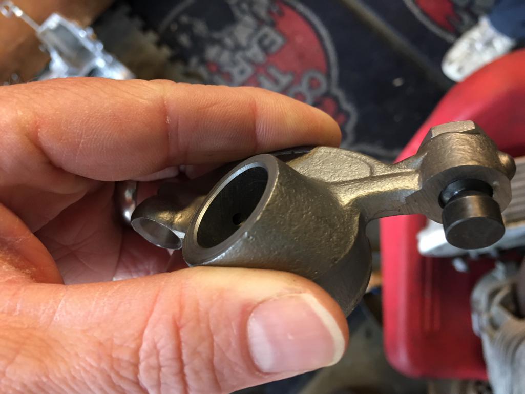

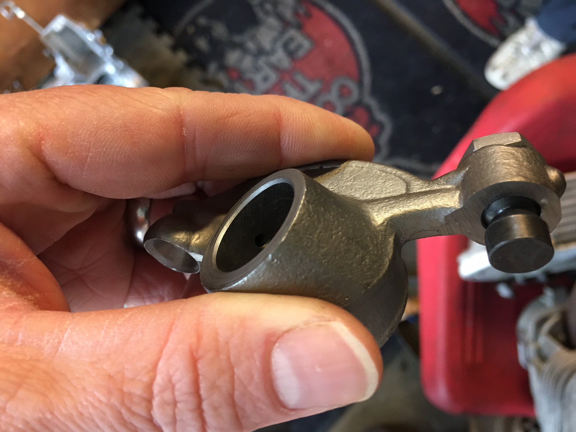

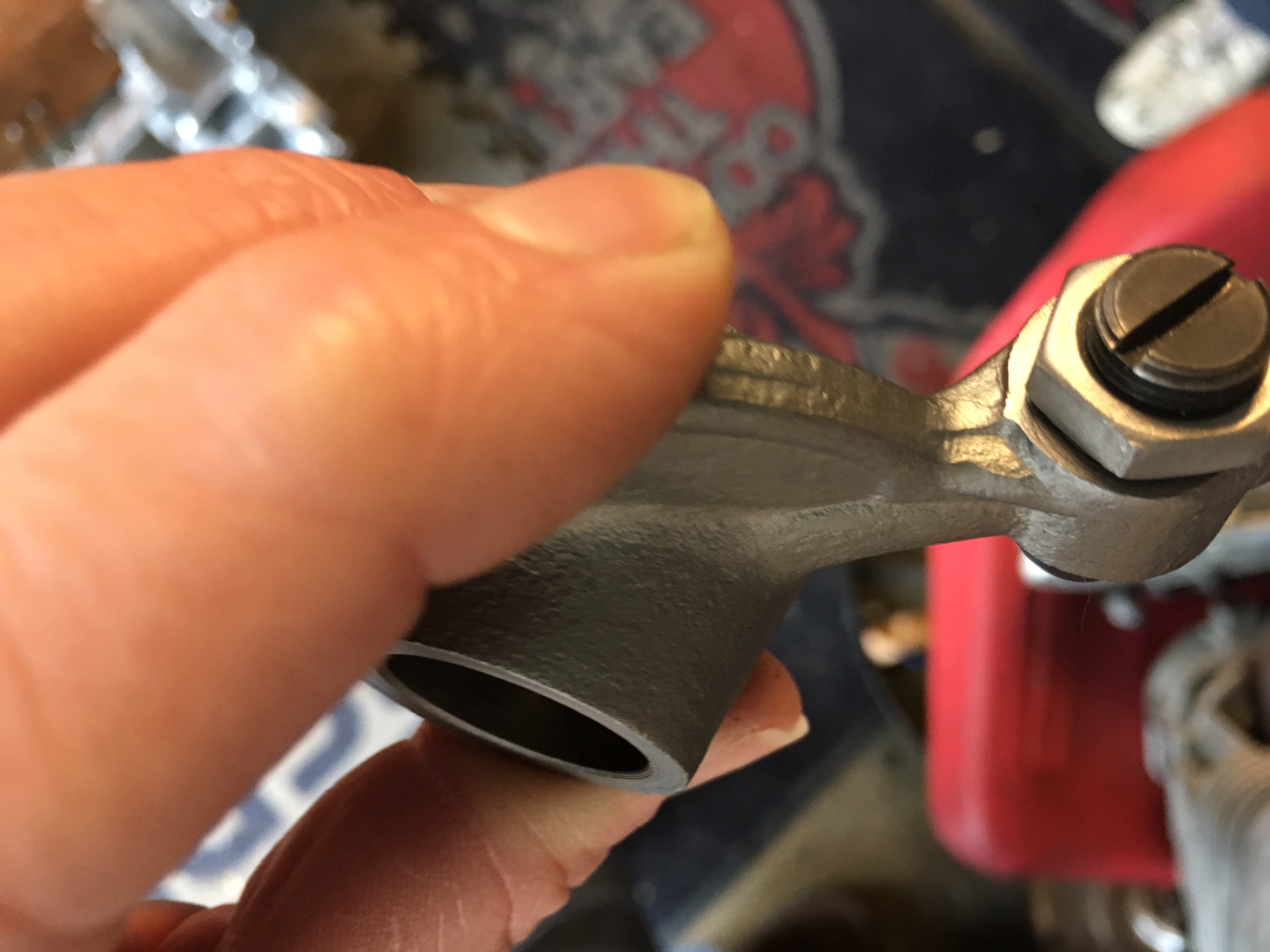

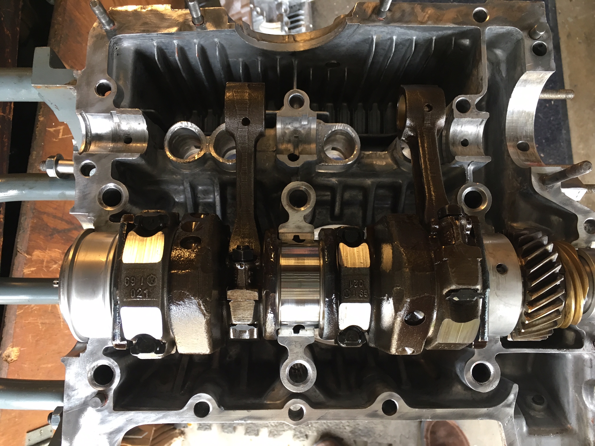

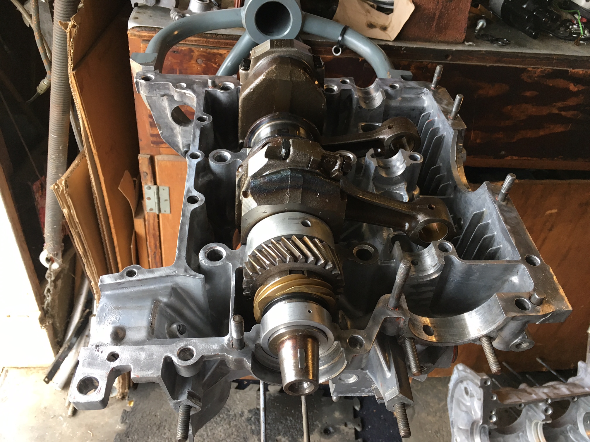

Pics inside the engine with new bearings and the rockers that will replacer the Pauter rockers.

mtndawg   Engine was dropped. Here's a photo of the Paut...   Mar 5 2017, 05:08 PM
mtndawg   Pics inside the engine with new bearings and the r...   Mar 5 2017, 05:16 PM

Dave_Darling   44s are very likely going to be too much carb for ...   Mar 6 2017, 05:11 PM
bretth   Why remove the Pauter rockers? Are they worn or to...   Mar 6 2017, 10:01 PM
Dave_Darling   Why remove the Pauter rockers? Are they worn or to...   Mar 7 2017, 03:48 PM

Dougster   Why remove the Pauter rockers? Are they worn or t...   Apr 4 2018, 09:32 PM
jcd914   [quote name='Dave_Darling' post='2461584' date='M...   Apr 4 2018, 10:09 PM
Dave_Darling   It's not that 2.0 rockers don't need machi...   Apr 4 2018, 10:12 PM
mtndawg   Yes the 911 lug fits into the 1.7 rocker it does n...   Apr 4 2018, 10:15 PM
